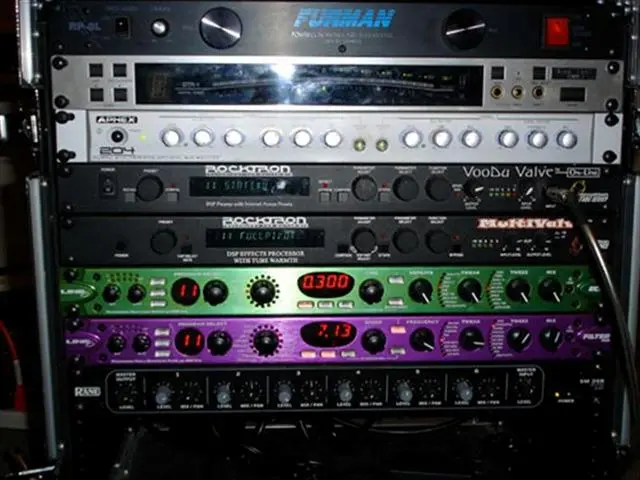

My guitarist has an unnecessarily complicated rig. His rig (including signal chain ) is:
Schecter Guitar -> Hughes & Kettner Tube Rotoshpere -> Morley Expression Pedal -> *Mesa Triple Rectifier Amp -> EFFECTS LOOP -> Rocktron Voodo Valve -> Rocktron Multivalve -> Line 6 Echo Pro - > Line 6 Filter Pro -> Aphex 204 Aural Exciter -> Back to Mesa
*We're still not sure whether we want to go to the Mesa and use the effects loop, or go straight into the effects first then end up on the Mesa. I would much rather go to the Mesa first, but its difficult to try to get the effects sounding as present, clear, and good through the effects loop.
One of his friends had previously installed this in a weird way. He had the (L) outputs from each unit going to the Rane mixer and the (R) outputs from each unit going in the input of the next unit, i.e., the Voodo Valve's Left output went to the Rane mixer and Right output went to the input on the Multivalve.
Here are my concerns:
(1) MIDI - Can his roland floorboard control all of this units? Can we program it so that one patch uses one effect from one of the units, and another might use one effect from three units? I presume this can be done, but how do we do this? Do we have to use MIDI THRU on the other units?
(2) Is there any way to avoid daysi chaining the signal? To clarify, I presume it would be more desirable to have the original signal divided into four signals to go into each input, kinda like what a splitter would do, rather than having the signal carry over into each unit from the previous units output. How do the pros do it?
(3) Finally, does he really need all this crap. I'm of the opinion that there is too much overlapping. I think he should get rid of at least one of the Rocktrons, and maybe both.

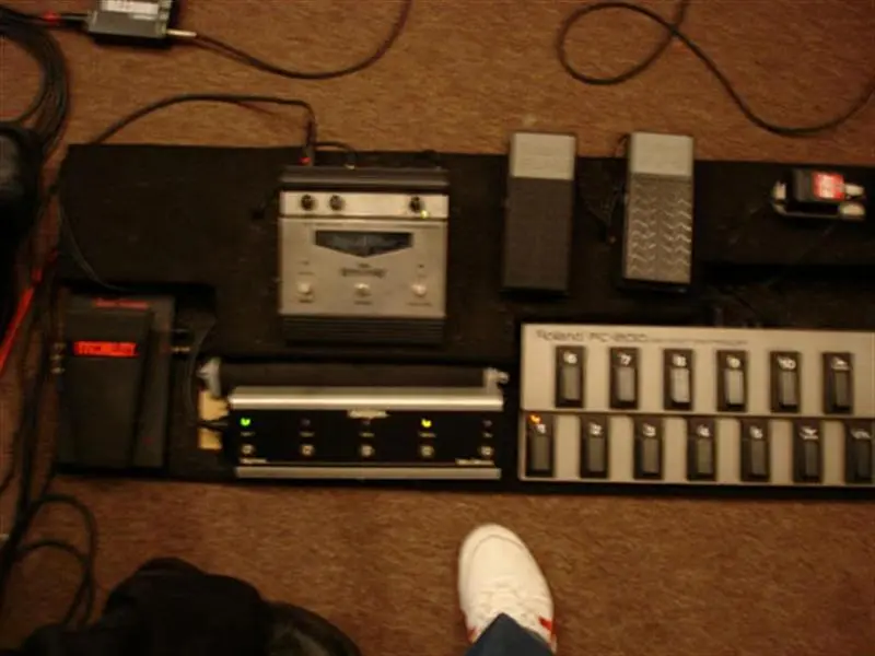

I've attached pictures to give you a visualization.
Thanks in advance!
Here's the floorboard
