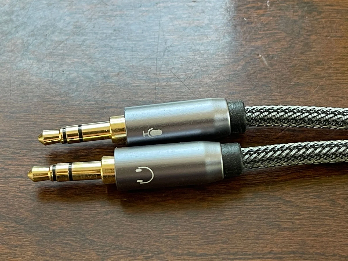

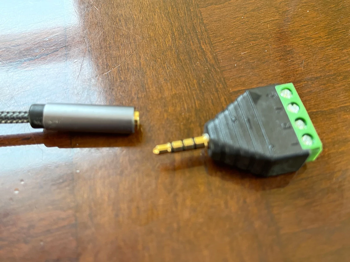

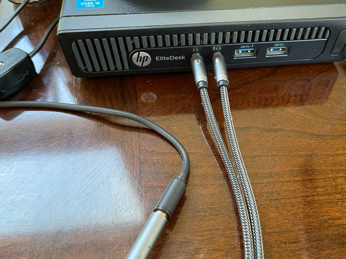

4 connections -left ear, right ear, common ground and mic. What is the mic 3rd connector (when split off) doing?It's a headset, so two of the connections are for the stereo headphones.
A mystery indeed. So much so, I decided to leverage my vast resources (went to the van and grabbed an adaptor and meter) to see if we can't solve just that.4 connections -left ear, right ear, common ground and mic. What is the mic 3rd connector (when split off) doing?
