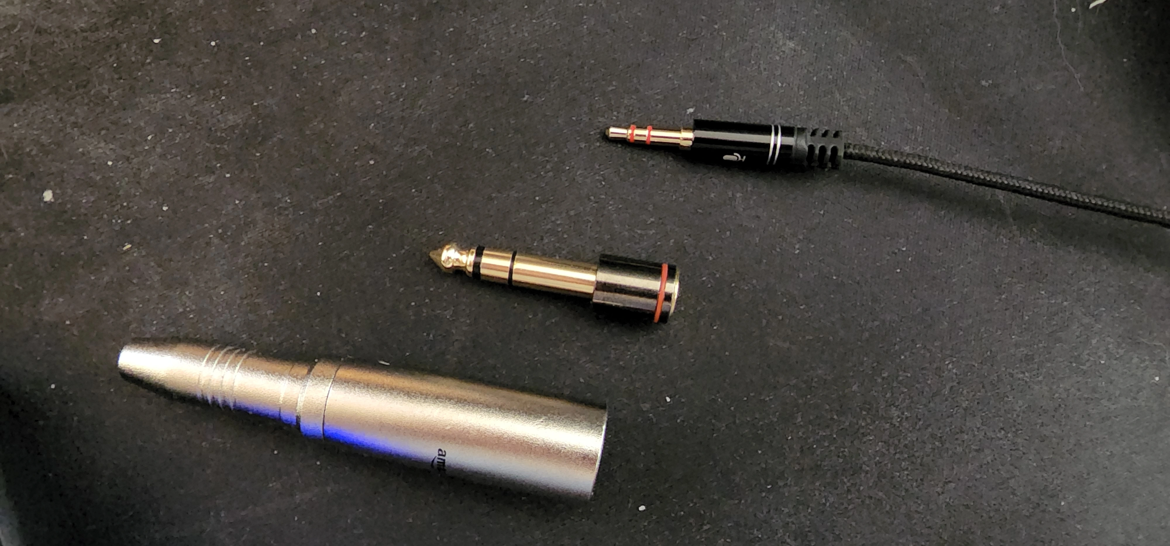

I am using a female 4 conductor mini plug splitter cable to dual trs, 1 for mic output and 1 for phones output
and I am plugging the 1/8 trs mic output into a 1/8 female to 1/4 male trs adapter and plugging that adapter into a xlr female to xlr male adapter and plugging that into the mic-xlr-in on the back
The guy from sweetwater expressed uncertainty about how I would make the connection work with an adapter and said he didn't know whether an adapter existed. So I just bought some adapters that seemed like they would work.

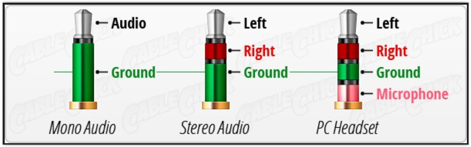

Here is the wiring diagram for TRRS along with typical TS and TRS. The challenge is ensuring the pinout of the adaptors you are using gets you + and - to the input as Boulder says. The adaptor I use, the mic side is 1/8 TRS which at first glance, doesn't make sense. I'm not certain which is + and - but the adaptor TRS has to have two that are the same from the TRRS. A meter doing a quick continuity check on the pins might make things a bit clearer.

If you look at the image I posted of the TRRS, you'll note that there is one mic+ and a common ground used for the headphones and mic. The Y cable (I presume that is what you have?) splits the L&R plus ground for the headphones and the other side of the Y cable is the microphone. On mine, it is TRS (Tip, Ring, Sleeve) but there are only Mic + and ground on the TRRS. See what I mean? Two going to three on most Y cable adaptors.

I think I get it, the female trrs end has mic signal on the bottom and its connected to the tip and ring both on the male trs y microphone cable to make continuity with it. So the female trrs y cable trs male microphone out side has mic on both tip and ring apparently, and seems like ground on the ground.
Multimeter was buggin out on me
Now that I figured that out, does this certify incompatibility?

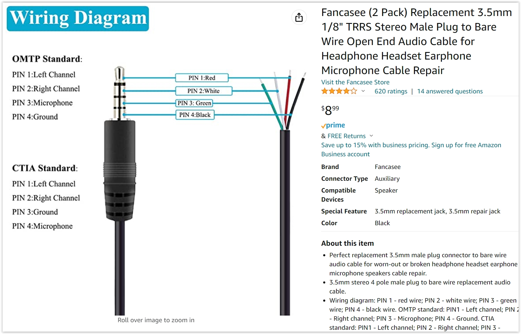

Good question. I use a ton of stuff like this I get off of Amazon because I have to connect stuff up to DSP's and often transformer isolators to get rid of buzzing.

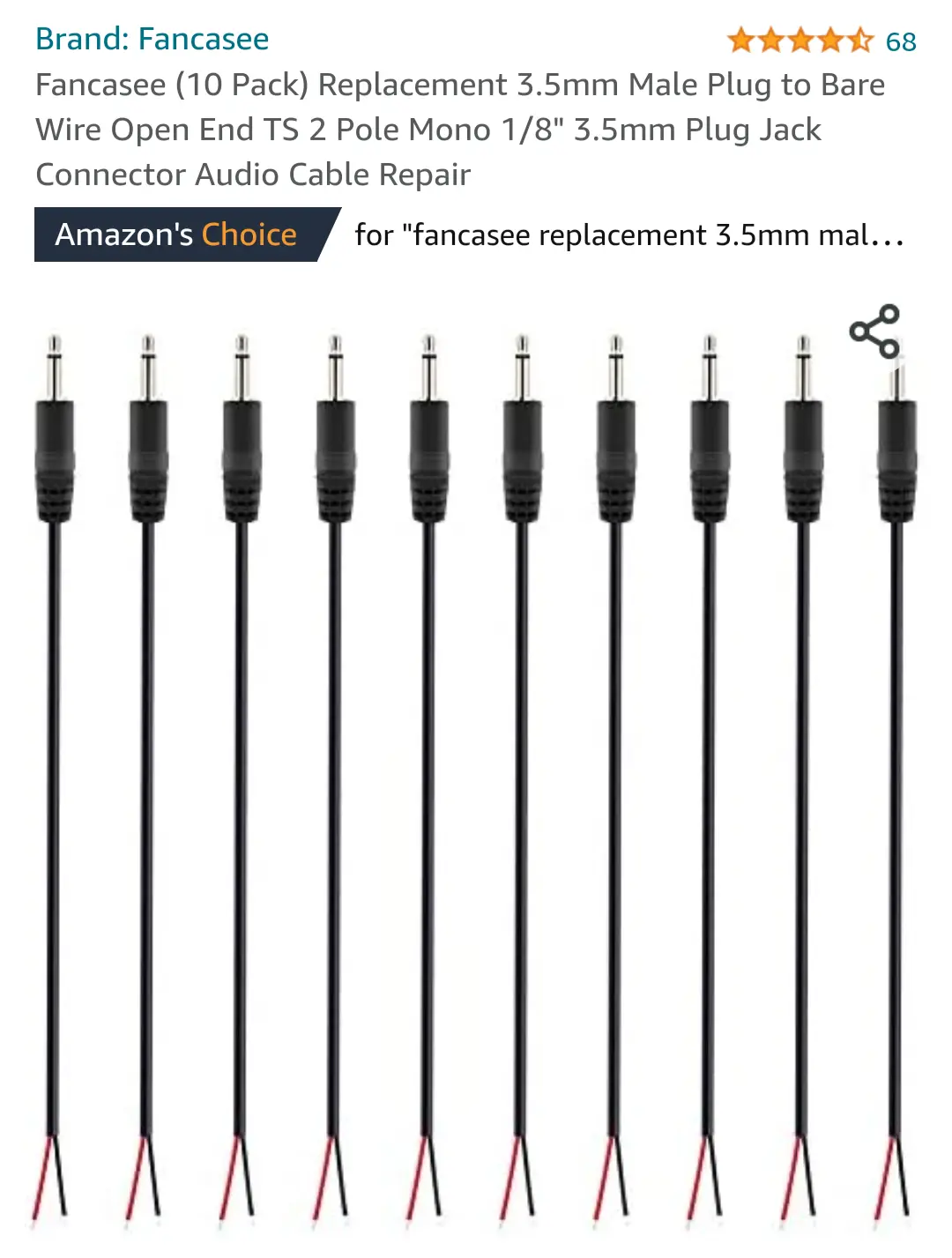

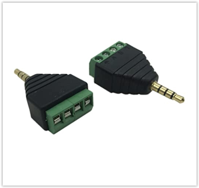

So maybe i could just get a 1/8 ts male to bare wire and swap the trs mic connector with it
Like this
Would that disconnect pin 3 on the xlr?
