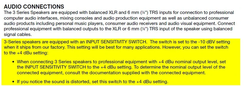

Pro & Non Pro Line Levels
All you really need to know is what is stated in the LSR305 manual for setting the -10dBv/+4dBu switch....
