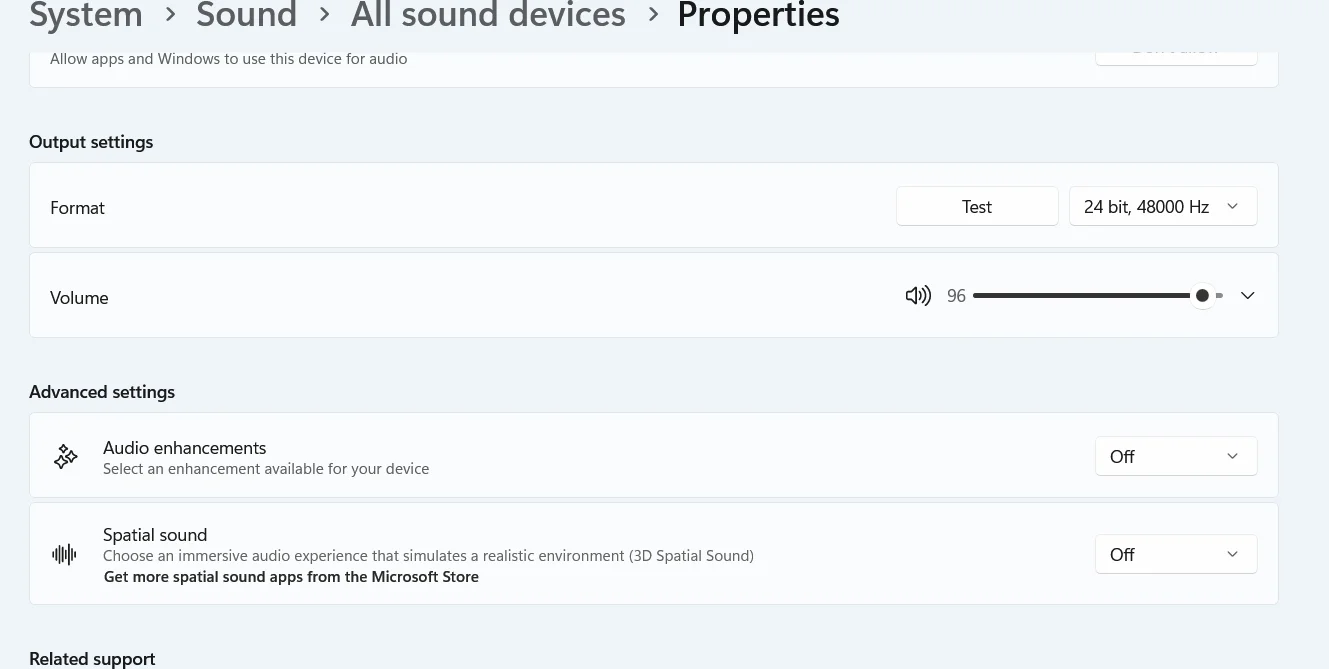

Make sure all the "audio enhancements" are turned of in Windows. You want audio to be unadjusted by the OS.
