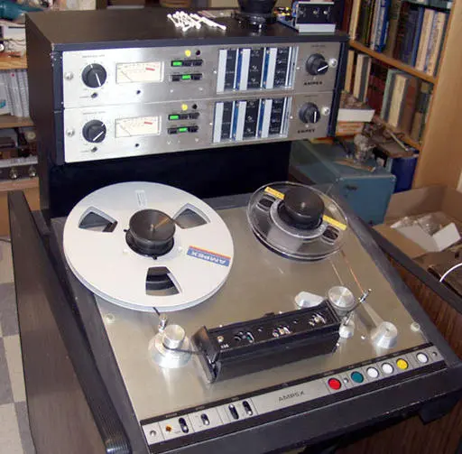

The select switches on the 440C are pushbuttons that mechanically change color when they are pushed in. I think schadow is the brand (??). On the 440C they are either red or green when pushed in, and black when not. There is a little set of shutters that cover the color when the switch is "off". Its nice as you can see the settings from across the room.
They are neat but since the "color" part is anchored with a fragile plastic prong, they tend to break as they age, then you get color all the time or the little shutters open only half way or some thing irritating like that. . It does not affect the function of the switch in any way; you just lose the visual indication. I've mused about trying an LED conversion.......

Is that a picture of the machine you just bought? :confused:
It cleaned up pretty good if so!
Cheers! :)
Ha! No, just a ripoff pic to answer the switch question,

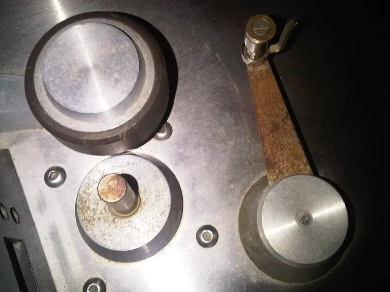

The right hand reel adaptor is frozen to the takeup shaft. I am trying some penetrating oil, but might have to surgically remove it with my dremel tool.
I have a spare tension arm and capstan cap, so I wont even mess with those.....just replace

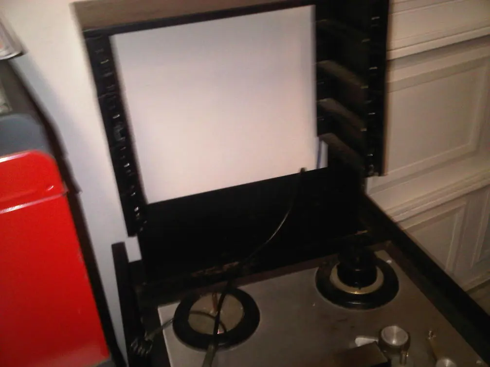

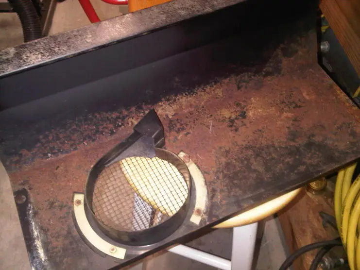

The rusty belly pan looks like it had water standing in it? The outside is fine though, so a wirebrush / prime/paint will get this right.

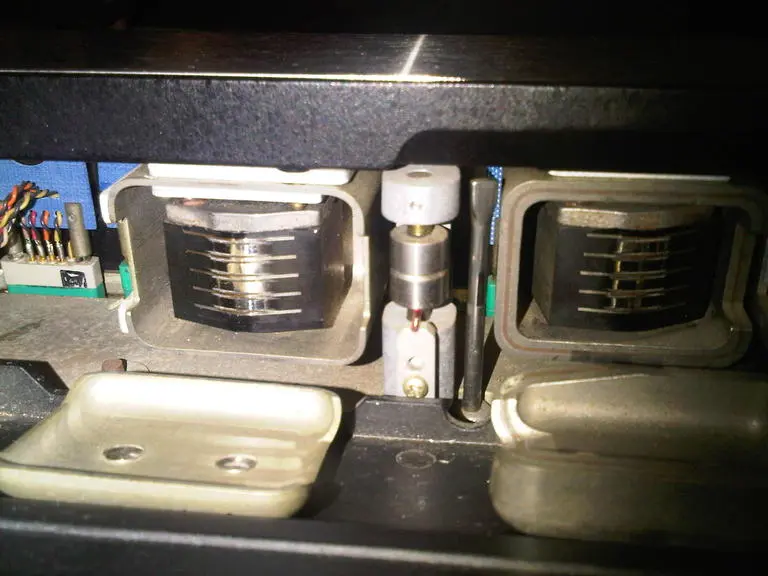

Surface corrosion on the upper deck components, but doesnt seem to have affected the headblock. The top surface seem to have the worst issues.

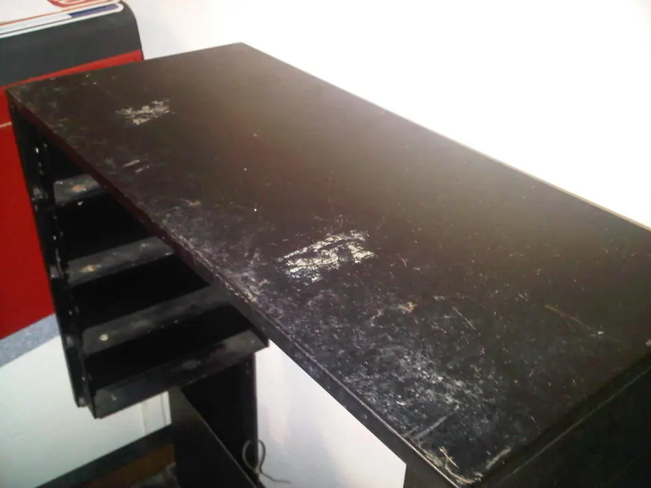

Anything painted black...the reel table surrounds, the entire cart structure..needs a scrub (or sand) and repaint. For the sake of protecting the pieces, I am working on cleaning up and restoring the cart first so I have something the hold all the other parts while I work on them

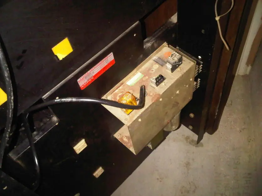

The servo box is undamaged and complete (I have the card pulled out in that picture) but the motor did not turn in my storage unit test. I have not tried it now that its at the house. I need to clean up all the connectors and check continuity. Yes, that is a broken lock tab stuck in the connector!! The top of the servo box, like all top surfaces, shows surface corrosion. As does the top of the electronics stack

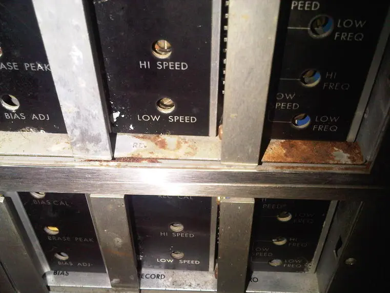

I wish the card covers were in place, as it might have stopped the corosion under the front of the cards. Most of the cards themselves look ok. I am concerned about some component lead oxidiation, and on the equalizer trim pots on the front of the cards....need to be a clean and sub them into one of my working 440's to see if they are a problem. I am going to have to completely gut the electronics modules to remedy this issue..

Is that rust in front of the cards in the amp modules, or is it just yuck?
The servo getting power? Dunno how it is on that one but mine has a small twist-lock power connector to tie into the line power...

I havent dug into the electronics yet, except to take off the top covers and scope out the insides....all good and clean. I THINK its rust on the edges, so as I said Im gonna have to dissassemble the modules.
I thought I only saw the one cable going to the servo box, unless there is a bottom side connection. I have to remove it from the cart for cleanup so I will get a good look all around at it.

Only one headstack :( but as I said it looked good to my eye.
