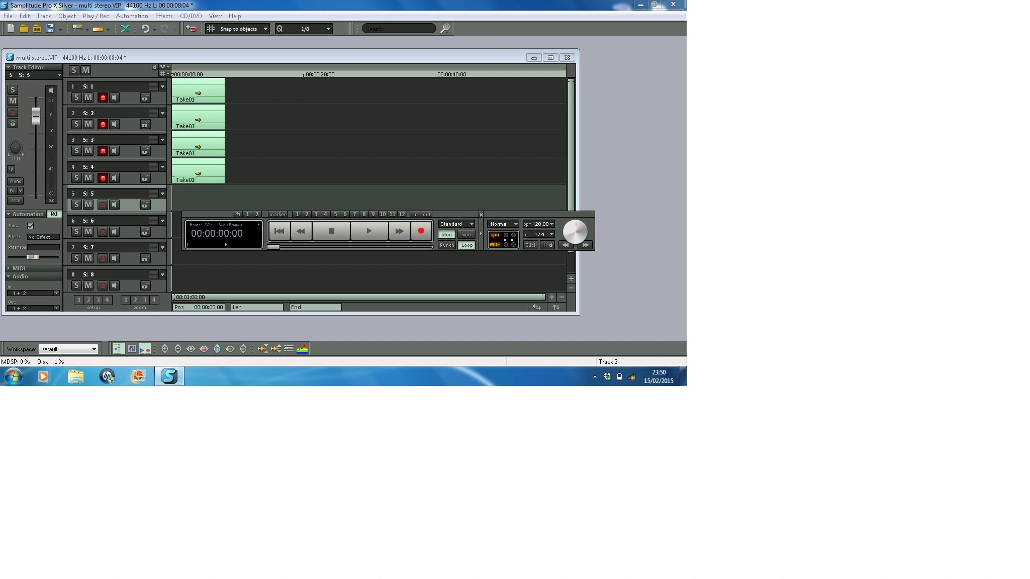

The attachment shows tracks set up in Samplitude ProX Silver (can a Reaper 'spert tell me if that can do it?) and I have set up a Behringer UCA 202 as tracks 1 and 2. KA6 as 1/2, 3/4 and 5/6 SPDIF.
This was all set up on an HP laptop because it and the AIs were handy. In the next day or so I will try to set up something better and run some recordings.
