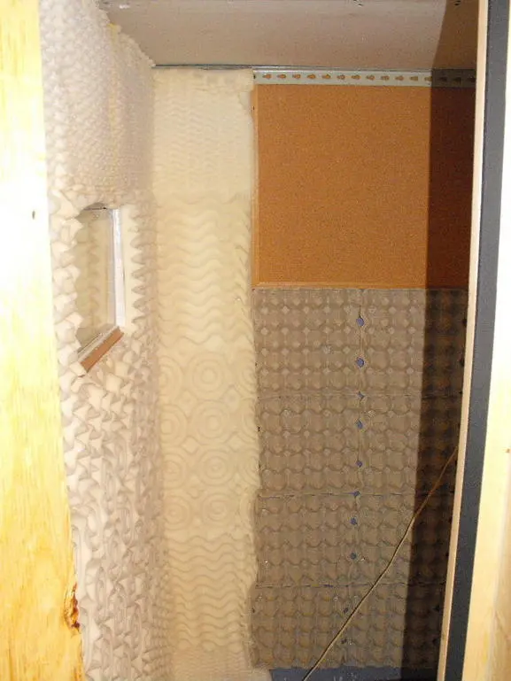

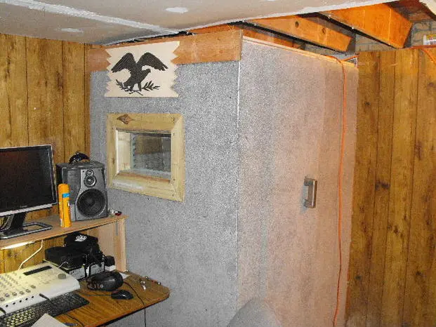

I know everyone is gonna crack on my about my mattress foam...it works fine for what I wanna do. Anyway here is a couple pics of my home made vocal booth.

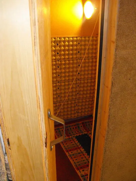

One more
I made the door. The walls are pretty basic....2x4s and 3/4in drywall. Stuffed with insulation. Of course the back 2 walls are existing basement walls. I Tapconned (is that a word?) 1x4s to the brick for framing. I then put in a layer of plastic sheeting and moistire proof drywall. Covered the thing with carpet on the outside and mattress foam and egg crates for diffusing on the inside. Double paned window. Nothing on inside ceiling.
Ok all you perfectionists and sound engineers...pick away!!:D
Not sound proof, but isolates my condenser mics from computer fans and most peripheral noise. Actually, considering the mony I got in it (Couple hundred or so) it works pretty damned good.

Of course you know what I'm going to say, so I won't say it. It's not the way I would build it, but if it's working for you, who cares what I think? :)

LOL... pretty tech bro :) Would you say the foam or egg cartons is a better sound barrier?
It's a long time since I've seen someone on here ACTUALLY use egg cartons! Bloody hell, that place is a death trap!
For real!!! absolutely no smoking or open flames near your booth but I'm sure your aware of this fact.
Nah, if he was aware of that fact, he'd also be aware of the fact that egg crates are completely useless when it comes to ANYTHING that has to do with sound.

Why do you need a booth? Is it for vocals? or voice-over work? Voice-over work can be done in a small booth that is trapped properly. Vocals (singing) are usually done in the 'big room' surrounded by absorption panels.
If you would have asked for recommendations here before you started, you could have built a killer booth for $200 -- well, maybe a little more.
One that would be safe and sound-proof too. Your recordings in that booth will sound 'boxy' because you do not have any trapping but only mid/hi frequency absorption.

It's true that a lot of people are against the whole eggcrate foam thing, but I'll be honest - I've used it in a pinch with surprisingly good results. Look, any type of surface with absorptive properties is going to be better than 4 parallel, untreated, hard surfaces.
That being said, I wouldn't invest in bed foam from your local Walmart for a project like this... If you've got it lying around and you need some quick treatment, the eggcrates are probably going to be better than nothing.
The reason why some people are dead-set against the idea of eggcrates is because of the inconsistent noise reduction coefficients across the frequency spectrum. Because of this, your recordings could potentially end up with problem frequencies (too much of some, not enough of others). But ultimately, if sounds good to you, awesome!
You can get actual acoustic treatment foam for a room that size for very little money, so it might be worth it to do a little Googling. It doesn't have to be Auralex. If you look at the NRC's on the cheap stuff, some compare favorably to the expensive stuff.
To test if you have some problem frequencies in the room, use a good studio monitor and a fairly flat mic. Put the monitor in front of the mic, and pump in some white and/or pink noise. Use a spectrum analyzer and compare the original noise signal to the one that is coming back from your mic. If they're pretty close, looks like your room is set. If not, figure out what the problem frequencies are and Google how to fix them. More than likely, the problems are going to be in the low-end, and adding a bass trap might help.

The reason why they test "favorably" is because they stole their test results directly off the Auralex page. I'll just go right ahead and call out Foam By Mail. That's exactly what they did. Ethan Winer actually tested their stuff and proved pretty conclusively that not only was it NOT in the same league as Auralex (let alone GIK, Real Traps and the like), but it's complete crap. The absorption coefficients were not even close.
