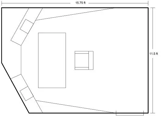

Well, as promised, here is my concept for the control room. It is pretty straightforward. Splayed walls from the front as far back as the doorway. Soffited speakers located on an equilateral triangle with the mix position. For treatment, there are a number of ways to do it but I would probably use the soffit area beneath the speakers for space for bass trap hangars; put some absorption on the side walls; and some absorption on the back wall (possibly spaced off the wall to provide some bass trapping as well). Hopefully Steve or one of the real experts can provide better details on this aspect, but I think it is pretty close.
Good luck,
Darryl.....
Thats AWESOME.
Thanks you so much, my design isnt half as functional as that. I still want to preserve a window that looks out into the recording room, and this will allow that. Cool Keep it comin'

Most of this HAS to be done after I am issued and occupancy permit by the city. I am a HUGE believer in the building code and I have followed it to a T.
As this clearly indicated, I am waiting for my occupancy permit, moving in, and starting studio construction. I do not need another permit to build a home studio up here.
AND THEN, Darryl posts a design with.....DOUBLE WALLS and your all beside yourself over a design, which YOU negated right from the getgo.
That was my original point of view and it still stands tru for the recording room (single wall). As I have clearly stated multiple times, I know next to nothing about studio design and I am open to all suggestions. The control room design appears to be conservative enough for my budget. Speaking of, I also clearly stated in the previous post I have some extra funds available to me. So, when you add in the fact that I do not know a lot about design, add some extra money, and then a solid control room design, you shouldnt be surprised that I chopped at the bit here. At first I was hesitant to place the entire 400+ sq/f in a double wall. Given the extra funds available I may float the floor and put a double wall in the control room. Its not like a design to change plans in the concept phase now, is it?
I apprecaite and fully understand you were under the assumption I wanted to keep all existing walls, I do, just not inthe control room anymore.
"(I play soft music, so the drummer doesn’t really smash the drums to bits)" ........
"I want to be able to play music loud down there and need some advice as to how to trap the sound.
