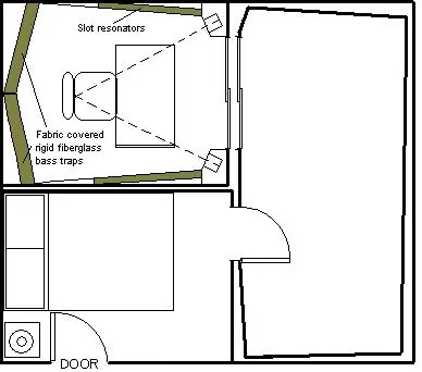

Well, my room is 14' x 8' x 5'6-6'6, so could basically almost fit in your room twice, and I'm spliting it into 2 rooms crtl and tracking, granted I'm not gonna be sleeping in it though :D. I've drawn out a rough plan of something i think would work. The control room is based on a few(most)of john slayers designs.

I´ve been in control rooms that are really big. The problem is I don´t have more space available. Pandamonk nice drawing. I think I should show this to the architect, it could give her some ideas.

In my drawing, the triangle at the back of the control room would be a large bass trap.
One bass trap??? :) watch the videos at realtraps.com. 8 traps are standard, and you can sometimes get away with 6.
I didn't mean that it was the only acoustic treatment for the room. Btw on real traps, the room is square or at least rectangular. The design i posted is based on john sayers, and isn't rectangular. The walls angled towards the back of the room could be slot resonators, for instance.

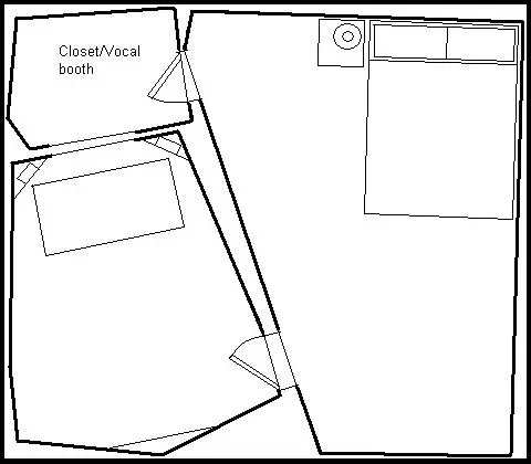

I've actually drawn out another for you. What do you think?

Thanks Pandamonk that´s exactly what I needed, more layouts!!. Could you tell me what software do you use for those drawings??. I like the second more than the first.

Lol!, how do I get into CR???, through the window??? :D I need another door I think.
