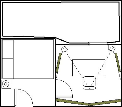

And another

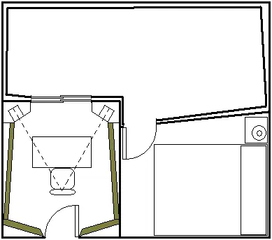

And yet another :p
So the control room is the same size as the double bed...
I think we need to look at correct scale here. Also the room is smaller than my studio and i only just manage to record bands in my studio. Wouldn't it be better to just use the whole room as live and control room.
That control room would be so small you could barely fit one guy in there. Many people i know have split up their small rooms hoping for better sound and more professional enviroment and they're all knocking down they walls they built.
The studios just become to cramped to work in. I'd really re-consider WHY you need to have seperate rooms.

Well, I though a CR could help me, I really don´t know what to do. As I mentioned, right now I record local bands in just one room, no isolation, no acoustic treatment, just blankets, carpets, curtains and the stuff this room have. Now I have to divide it to be my homestudio and bedroom.

Not the size of the double bed, the size of the room the double beds in. I know it's small but if theres only gonna be one, or a few people in it then it'l be fine, as long as there is enough absorbsion. If you think that's small you should see the room I'm gona be working in. 7'6 x 6'6 x 5'6-6'6

I made it that small because if i didn't there would be no room for either the bedroom or tracking room. In the first suggestion i joined bed and tracking rooms, with just a small vocal booth to fill the space left. Tamasabian said he wanted them separate, i think, so i made the control room smaller to fit them both in. It will be just big enough to work in, but may not sound all that great, but surely if he installs enough absorbsion it'll be better than tracking in the same room.
