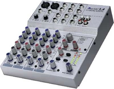

Here it is
all inputs are correct the DAW im using is audacity
If, when you play it back, its sounding through your PC speakers, then you do not have have the output device selected as the Behr in Audacity.
Your sound device for other applications in your computer (i.e our web browser, etc) is still the internal soundcard, that's why you still hear youtube through the PC speakers.
