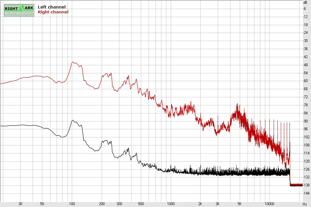

Looking at the spectrum I can only conclude you are hearing that slight peak at 5kHz? I don't have a bloody chance of hearing that! Then again the inabilty to post .wavs means I have to convert MP3 to .wav for the spectrum A and who knows what gets lost/corrupted?

Apologies all round. I should have sent the smaller file!

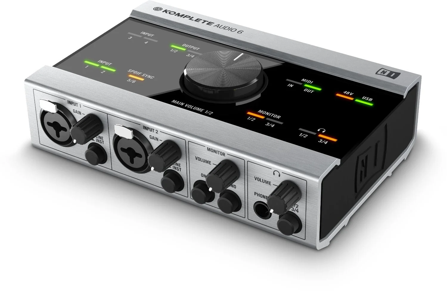

Just one of many, the Komplete Audio 6 is not a bad piece of gear. RME pres, phantom power, 4 inputs. Built like a brick sh... I mean... like a tank... and performs well.

Okay, that sound you hear is EMF from the computer that is being picked up by the interface. Try moving the interface to different locations to see if you can minimize or eliminate it. Also try a different USB cable, specifically one with big choke filters on it.
Hmm, my ZED 10 is 1.2 mtrs from a desktop (therefore in a tin) computer and the mixer itself is a steel box. The connecting USB cable is 5mtrs long and STILL we get HF artifacts. I believe the problem to be an inherent design flaw in the whole 16bit, generic USB audio system.
You may be right, however it sure sounds like an EMF incursion to me. 5 meters is very long for a USB cord. I'd still give it a try with a shorter, quality USB cord with filter chokes on it.
This is great, thanks so much guys. I'm glad it's the interface and nothing to do with the ribbon mic (which was more expensive!) This has been driving me crazy for ages so you've saved me from a lot of agony!! :D
