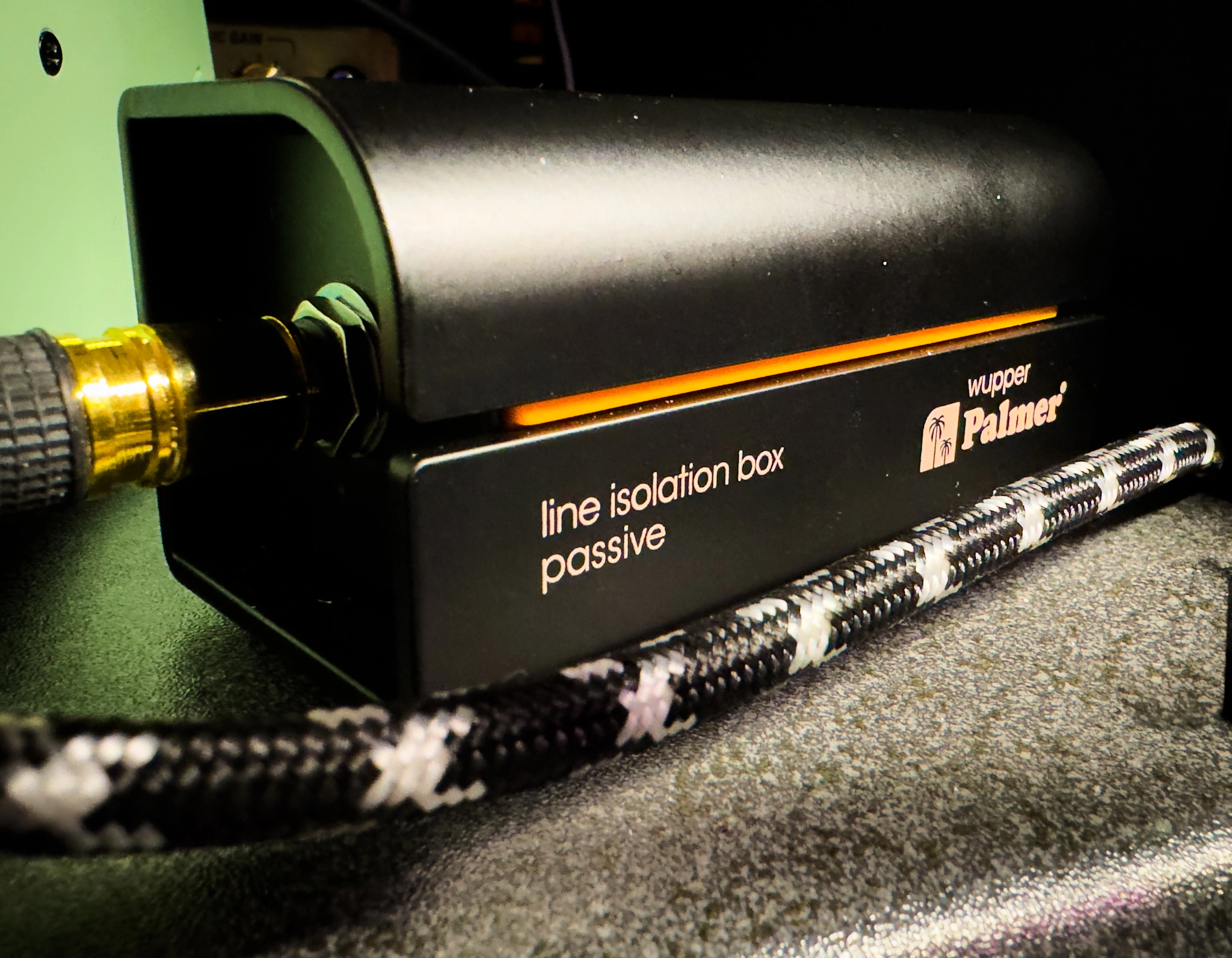

I've took some time to make sure my set was as silent as possible.
Power supplies are on switches, one group to two power conditioners and it all worked great till i connected my DI signal via a JHS splitter.
As soon as the cable went into the interface there was a very annoying whistle. No Humm no noise just an annoying high pitched very soft whistle.
I've reconnected everything several times and decided to get the palmer line isolator after testing a hd400 (behringer) which did work but destroyed my signal.
It's very affordable and aimed at guitar/bass with a 1:1 transmission. And ... It works like a charm. As soon as I connected the box the whistle was gone.. silence is great ;)
Im not affiliated with palmer but wanted to share my experience seeing it bugged me for months and wish I found this before.

The palmer keeps it all in tact.
