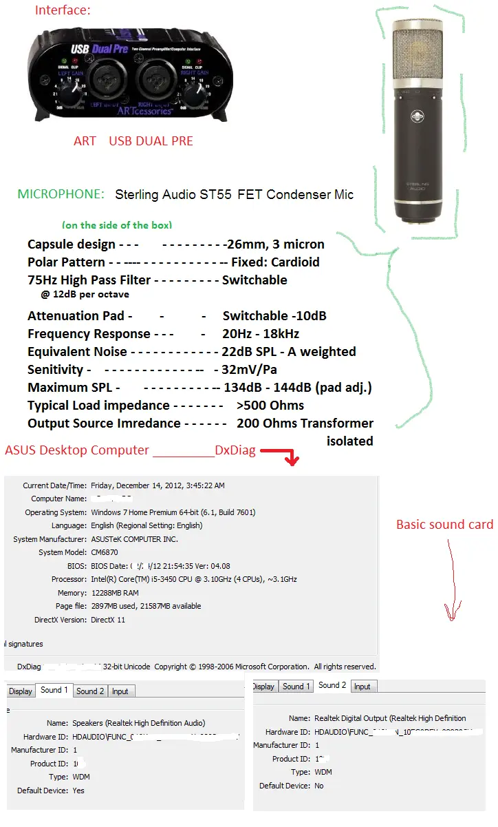

--First Problem! Walking into Guitar Center with over $200 store credit and over $200 in my pocket. And i'm 19 years old so... I did something VERY VERY DUMB. I walked into the audio section and told the clerk, "I want to record my guitar and vocals with my computer! Show me what to buy please!" So i left with over $300 in equipment that i BARELY knew how to use. I got it all working but its really quiet. And the quality isn't very good either, it sounds like i recorded with a stage mic onto a Line 6 Looper pedal. But i'm not entirely sure that there's a quality problem because the volume is so low. I also had some playback problems. When i would try to record on top of other tracks, the meter would move but... "silence." (But I think the problem is either one, my sound card, the way i hooked everything up, or the fact that i wasn't very comfortable at all with the software)
I have made a nice, easy-to-read picture of my gear. (computer,interface,mic) It's an attached file on this thread. I'm sorry, I know its kind of a hassle to download a picture. But i'm going to hopefully make a reply with the picture already showing so you wont have to. And for software, I just bought this computer and it came with an ...80% trial of ASUS Music Maker . So i used that.
Gear:
PC: ASUS Desktop computer. I print-screened the Dxdiag for you. It's on the attached picture along with the other gear.
Art USB Dual Pre: Left and Right 1/4" /XLR in. USB out to computer. It did not come with any software. The CD that came with it was only Audacity. that's all.
ST55: I've used it a little to record on my friends Mac and it worked extremely well. warm acoustics! (a lot more sound than what i got using my setup)

A couple of things to check.
The mike is a condenser mike. As such it needs phantom power. Do you have it switched on?
Avoid using your computer's soundcard. Use the Dual Pre as the playback device. Monitor your recordings using the headphones, and adjust the mix between computer and preamp to taste. For playback, connect speakers via the L & R monitor outputs.
So that's what those 1/4" L R monitor outputs are for!?!?
and yea im 99.9% sure phantom power was on.
If i get a 1/8 to double 1/4 adaptor would that be ok to plug headphones into the Dual Pre L R monitor outputs?
THANK YOU. i really appreciate it. (its 7am so i have to wait until later, but ill reply with results)
what's this i'm reading about a "converter." Is that the USB interface?
Naw, the 1/4" outputs are for connecting monitor speakers. Use the headphone out for headphones. The Mix knob on the back, controls what is output through the headphones. Counter clockwise; input signal from your mic. Clockwise; return signal from your computer/DAW.
Yes, the interface is a analog to digital 'converter.

Well thanks to you two. I got it working! THANK YOU!
