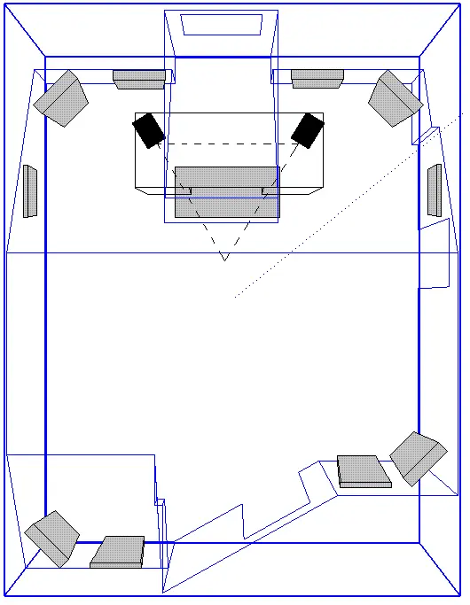

I'm going to see how easy the rocksilk is to work with, but I've drawn up plans for a 2m x 2m isolation booth, but considering how much material is costing, It'll be a while before I can start work!!
My studio has sloping ceilings so where would be the best place to position these traps? Should I just keep them in the corner on the ground or elevate them up a bit so that they're in the corner & hugging the point in which the sloped ceiling meets the wall?

What's your plans like for the iso booth? We should be able to help with that.
Is the ceiling just sloping one way, or does it go up to a peak? Could you draw out a plan of your room, showing where the ceiling slopes, and where you are putting the booth(Just use ms paint, if you have nothing else).

Here's a bitmap of the room;
http://www.mediafire.com/?2zumy1e1njg
Here's a sketchup file;
http://www.mediafire.com/?5jnqssnovxm
The isolation booth is something for the future, but basically it's going to be an internal space of 2mx2m. Internal wall of 9mm sterling board, then 100mm rocksilk, then the outer wall of 9mm sterling board. the booth will be made of these modular panels around 1mx1m connected to each other by external brackets. Each panel's internal wall is connected to the outer wall by 4 blocks of wood sandwitched between neoprene. It'll cost a fair amount of money, probably around £300. My only conserns being the strength of the 9mm sterling board, I can't afford anything thicker, so I may have to reinforce the four floor panels & the door frame.
Will it be in this room, or another?
Why not use plasterboard or MDF? It will be a lot heavier/denser, and will therefore isolate better. It should be a lot stronger also, and should look a lot better and be easier decorated. I wouldn't put rocksilk in the walls. For insulation between the walls, just use the cheapest insulation you an buy. I really doesn't matter as long as you have something. If you could afford it, you could build 2 frames, one for the inner and one for outer, which if left unconnected and sealed properly, will provide much better isolation.
I've drawn up, with paint from the sketchup file, a placement plan for your room. If you go with what i said, 5x4" and 10x2", then I'd use 4x 4" in the corners, and half one for behind the monitors. With the 10x 2", 1 on the ceiling, 2 on the back wall, and 1 halved on the side walls. You will have 6 left, and you can use these for more on the ceiling/side walls, or in your booth. Will you use the closet in that room as a booth(vocals and guitars)? I would.
