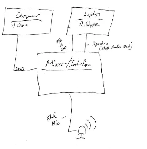

The problem I'm having is that I've acquired a virtual co-host and we've decided that Skype would be the best solution for the Podcast. However, recording skype audio is crappy via computer software (Pamela mainly) and it's extremely difficult to edit/mix/master in the long run because I literally have to rerecord myself. I'm thinking its my Fast Track Pro that is causing the audio issues.
So, I've done some research and basically came up with this diagram based on other podcasters that utilize virtual guests and hosts. And, this is where I need some advice:
My Diagram:
So as you can see from the above picture, the xlr mic is going into the mixer/interface, which is sending my audio to my laptop via mic-in (1/4) jack... All audio from the laptop is sent out the speaker/headphone (1/4) jack back to the mixer, which is sending ALL the audio via USB to the computer. (This is probably 100% wrong, but this is what I gathered from an evenings worth of research.)
That said, I wouldn't mind moving to a USB Mixer and use my Fast Track Pro just for the MIDI I/O, but I won't if advised otherwise.
I guess my questions are:
Is the above diagram viable?

First, is this live? If not, best you can do is record each voice on separate tracks and mix. So, on the DAW, have the Skype input on one channel and mic on another. That way you can control the mix for the mix down.
Example, Mic channel host track, Skype virtual host track. You should be able to split them out. If you do this, you can then process the virtual host's voice independent and get a better mix.
If I lost something, then help me understand.
I think I understand what you're asking but:
Let me get this straight: You're conducting an interview/conversation via skype, but you want to be able to record it and publish it later.
Ideally your friends voice would be recorded from skype, but your voice would be direct for better quality, right?
If that's the case it's not too hard to set up.
On mac I'd do this all inside one computer with soundflower (virtual I/O), but I'm not sure that's available to you.
So,
Plug your mic into 'input one' of the fast track pro.
Open an audio session in your daw and arm a track with input one. "one two-one two"
Now, set up the laptop with skype. Make sure that when your chap speaks he can be heard through the lappy speakers.
Use whatever cable you need (1/8" to 14"?) to run the laptop's output input 'input two' of the fast track.
I wouldn't worry if it's a headphone output. If it is, just make sure it's not set to 100% volume.
Set input two on the interface to "line" rather than "inst".
Set up a second track in your daw and arm it with input two.
Now if you speak, you're recorded directly onto input one.
If your pal speaks he's recorded directly onto input two.
You can use eq and comps. You have full independent mix control.
You can hear him through the daw (headphones recommended), but he can't hear you.......
Set skype/laptop to 'hear' you from the built in mic. Ok, it'll sound a little crappy, but the only person hearing it your pal so it doesn't matter.
This should do away with the need for feeding things back and forth through a mixer.
If you need this to be a live podcast, the advice might be slightly different.
That just depends how capable your podcast software is.
Is that useful?

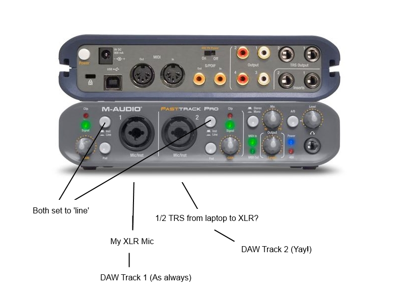

Ahh, thank you both for the info - it does make sense, but I have some questions!! :D
Let me find a fast track pro image and do some arrows and text so I can see if I understand this better.

Let me tell you, you guys are life savers, almost dropped $300 on equipment I don't need.
Here is the image and arrows based on my understanding of what you guys are proposing. Hopefully, I'm on the right track (pun intended lol!)
And, what do I do about getting my voice signal via XLR back to the laptop so he can hear me?
Also, is 1/4 TSR to XLR a good idea or should I use another method to get the audio from laptop to fast track pro?
Nope. :eek:
  • Microphone goes into fast track pro channel one - XLR to XLR - Inst/line switch doesn't apply to XLR ins.
  • Skype return goes into fast track pro channel two - 1/8" to 1/4" cable.
    The maudio 1/4" input expects line level signal level. It will 'like' your laptop output much better than the XLR input will.

Got it! So on the upper right-hand portion of the image, I should use the 1/4 TRS input #2 for the laptop stereo output?
Side question, do I have to use a TRS cable for this? or can I use a standard 1/4 unbalanced cable from the laptops 1/8 cable to the 1/4?
Yehp. That's it.

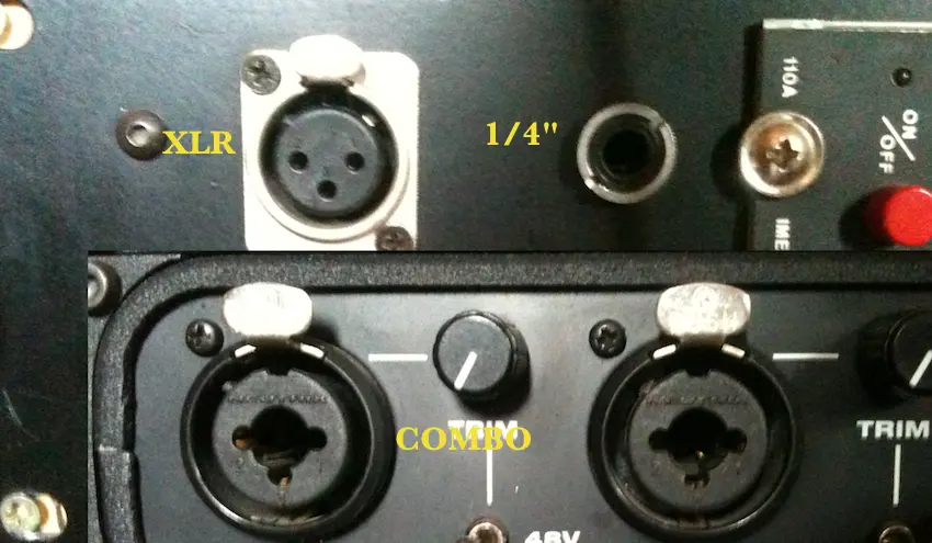

Okay so, what you're telling me is that each XLR input (below) can take a 1/4 input as well in that center hole??? That's weird and I would have never thought to stick anything in there lol, that's why I was confused I guess.
So do I even need to use the inputs on the back of the fast track if the XLR input 2 can take a 1/4 unbalanced signal from the laptop? o.O;
That's exactly right. Obviously each will take XLR or 1/4" - Not both at the same time.
If you plug in a 1/4", the line/inst switch has effect.
If you plug in an XLR the switch does nothing.

Here, maybe this'll be useful.
You can even see the copper XLR contacts in my lower left combo socket.
Those won't touch a TRS connector, see?
