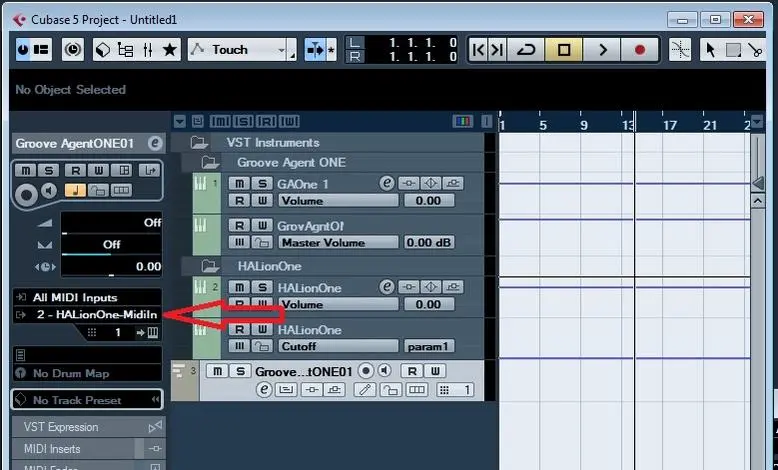

Got GA up and running. Now how do I toggle between Groove Agent for one track, and Halion for the next?
Just set up another VST Instrument track with Halion.
Or you can use the same midi track and just change the output. After the instrument is set up you can change any MIDI track to use that instrument by chosing it as the output for that MIDI track.
So in this pic I set up GA and Hal and can switch between the two with the output on the MIDI track.
Once again, you sir (or ma'am) ROCK! I think I've got it now :D
