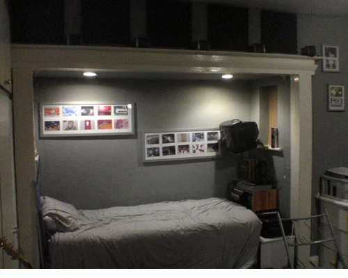

Ok, so i have an alcove in my room where my bed sits.... the walls surrounding it are all brick from where the house has been extended on.. this makes me think that it would be PERFECT for a vocal booth. I really only need to build one wall, to cover up the gap.. and a door of some sort. The problem with my room is that it is an upper floor and the floor is very prone to bass problems. Anyone downstairs can hear my monitors (Alesis MK2.. a very bassy speaker) even when they are quite low.
I will be putting a desk up against the wall i will be making... and i would like to be able to have my own mix as people record in the booth, without the bass flying through to the mic. What should i be making the wall out of/filling the wall with in order to stop these frequencies being blasted into the booth.
Also, how should i have my speakers placed/ what precautions should i take around the speaker to lessen the bass to the booth, because as i see it... the floor is so weak i dont think it will take much for the bass to come through to the next room.
Should i re-floor the floor in the booth? Maybe put a few layers of carpet to seperate it, or make it float from the floor below it?
The booth is roughly 8ft long and 3ft deep. Is this enough space to make a decent dry vocal recording? Should i be filling it will foam/ leaving area's clean to add a more reflective sound to the vocals?
I dont want to put a window in as i believe it would take the task to a much more difficult level and would be a huge hassle, instead i will probably wire in a camera to a TV on the outside of the booth so i can see in, good idea?
Please answer as much as possible, as i believe this shouldnt be too much of a difficult task. Thank you for any help you may give

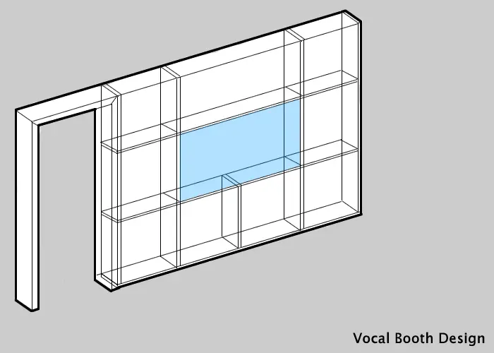

Ok.. no reply yet... but ive come to the decision that a window would be preffered... only i thing glass will be way to heavy and expensive to install... so i was thinking maybe 3 layers of thick perspects sealed in... would this be suitable soundproof wise?
Anyway, i played around with a few idea's of construction [See Attached Image]
* - The seperate blocks will be filled with either foam or another suitable material
* - A door will be hinged on to the frame, and padded out as much as possible to stop any kind of leaking
* - Frame will then be covered with suitable board to make it seem as one piece..

why is it divided into seperate blocks on the wall?
how else will i make it so the window will fit in? The sections are there as a frame for the window... then i will board it all up as 1 wall...
Foam is useless for sound transmission loss material. Mass is what you need, however, adding ten tons of mass to that one wall would be useless if the other 5 assemblies allow transmission to occur at a level lower than the rating of the partition you are building. Not only that, but you are putting a DOOR AND A WINDOW in this partition. THEY will be a weak link also.
Ok, it will be hinged. How else would you open a door? Padded? For what? Padding does nothing. Only MASS, DECOUPLING, and SEALING via caulk and or seals.
As one piece? I think you need to do some reading. What your drawing looks like is a cabinet. How are you going to hang a heavy door with no STRUCTURAL framing? This drawing does NOT illustrate standard stud framing. It looks like sheetgood construction. Which if it is, good luck. As to the sheithing, code would require a fire rated material since it is in a habitable room. That means drywall. How you going to fasten the sheets at the joints to a 3/4" wide sheetgood edge? I think you need to THINK this out more.
Frankly, you need to rethink this. Since you are ADDING a partition wall to existing space, it has to meet code. Especially if you are in a building with other occupants. I would talk to your local Building Inspection Department first. They will usually give you some guidelines to residential construction limitations, and requirements. But not always. It is up to you to meet code. And here is another caveat. Should you build this with NO permit, you could possibly set yourself up for violations resulting in fines, loss of insurance, or worse should something happen. Remember, this is NOT a fixture. It is adding a partition to a habitable space. Well, I'm out of time. Hope this helps. Sorry if it burst your idea bubble, but better be informed than not in these cases.

Useless. Typical. You come here asking for approval of YOUR useless designs, and when we tell you the REALITY, you get pissed. I got news for you. You don't have a clue. Thats why I gave you REAL information, not "yes, your idea will work". Of course it will work to an extent. But for what is the question. But in case you think you've got a handle on this...NOT.
'will what he has designed be suitable for a vocal booth?"
Don't you understand English. I did. What you seem to be missing is....HOW SUITABLE...you can't even define the fucking problems let alone the solutions. Why do you think I told you what I did.
which it could possibly do, instead of pointing out grammatical errors in my proposition.
Yes, it could possibly do. So will a frame covered with blankets...if thats what you accept. And what grammatical errors did I point out. Thats total bullshit.
Thanks for your "wise" comments, but i really think half of it was uneccessary critisism to an un-experienced 17 year old
Unneccessary? Is blowing your budget on USELESS construction "unneccessary"? Son, you need to grow up. If anything, I was trying to clue you in to the reality of isolation construction. You don't want to listen to the truth, but expect a lie, then so be it. Typical. I guess what you really want is a FAKE isolation space. You wanna "play" studio huh? Have fun. However, expect "play" isolation then. Adios.

Mass and Chaulk is by far more effective in controlling sound than foam, padding, blankets, etc.
The ideal vocal booth is where the singer walks inside the booth, the double 4" thick oak doors are closed, and the singer chaulks him/herself in, and the recording engineer chaulks the singer in from the outside.
Windows, doors, air ducts all potentially expose the microphone inside to audio other than from the vocalist (or guitarist, etc).
Basically, like everything else, it's about tradeoffs. My booth for example isn't even close to soundproof. And I'd be stretching the truth if I implied it was an isolation booth, because it's not. But, it does significantly reduce in-booth reflections, and hamper enough of the "machine noise" from the console room the booth is in, to get a good recording.
A lot of Rick's advice is ideal in the sense that by explaining the basic concepts, you can draw upon that to form your own design with the compromises that you have to due to the arrangement of your space, availability of materials, and the construction of your facility to begin with. Not everyone can pour a concrete floating floor, for example, but understanding the advantages of such a structure can help you grasp the concepts of sound isolation that you might make your own design better.
