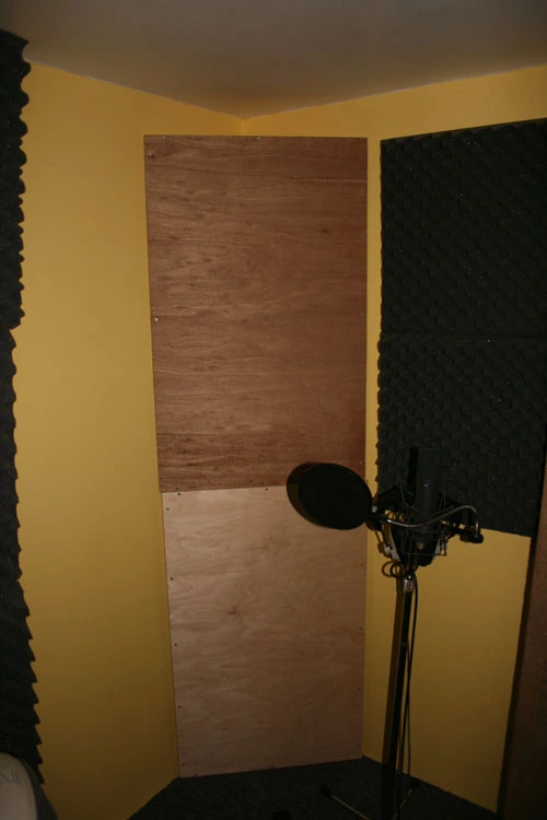

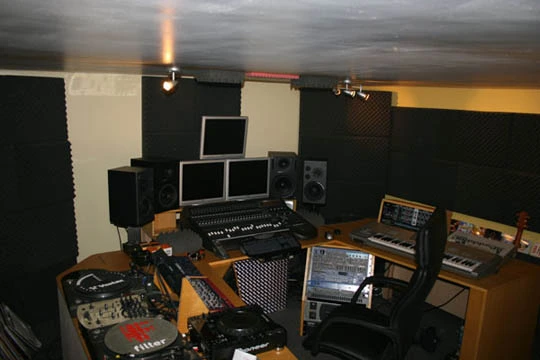

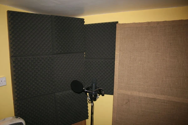

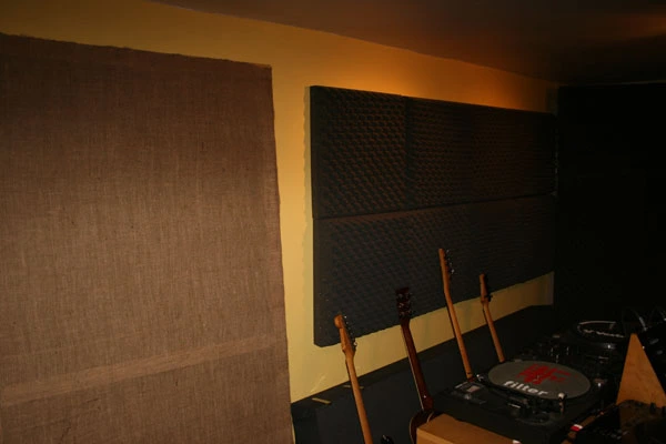

I see plywood straddling corners? You should be looking at broadband soft type absorbtion there - and thick.

Thanks for the replies, yeah the panel traps have been pointed out as being next to useless a few times now lol I'm gutted, when I first looked into acoustic treatment these were THE thing to have/do.

I answer to your previous post, I actually get a big cancellation at 100hz, I've used a swept sine and pink noise to analyse using a Java Room testing application. Behind me is a door with a bookshelf and a couple of broadband diffusers (about 12" deep) the rear corners are shown in the pics. I really hope this makes the difference I need I'll keep you posted. Thanks again
Is that a triple output graphics card or is it some other means of display?

The third monitor is for the mackie d8b.
