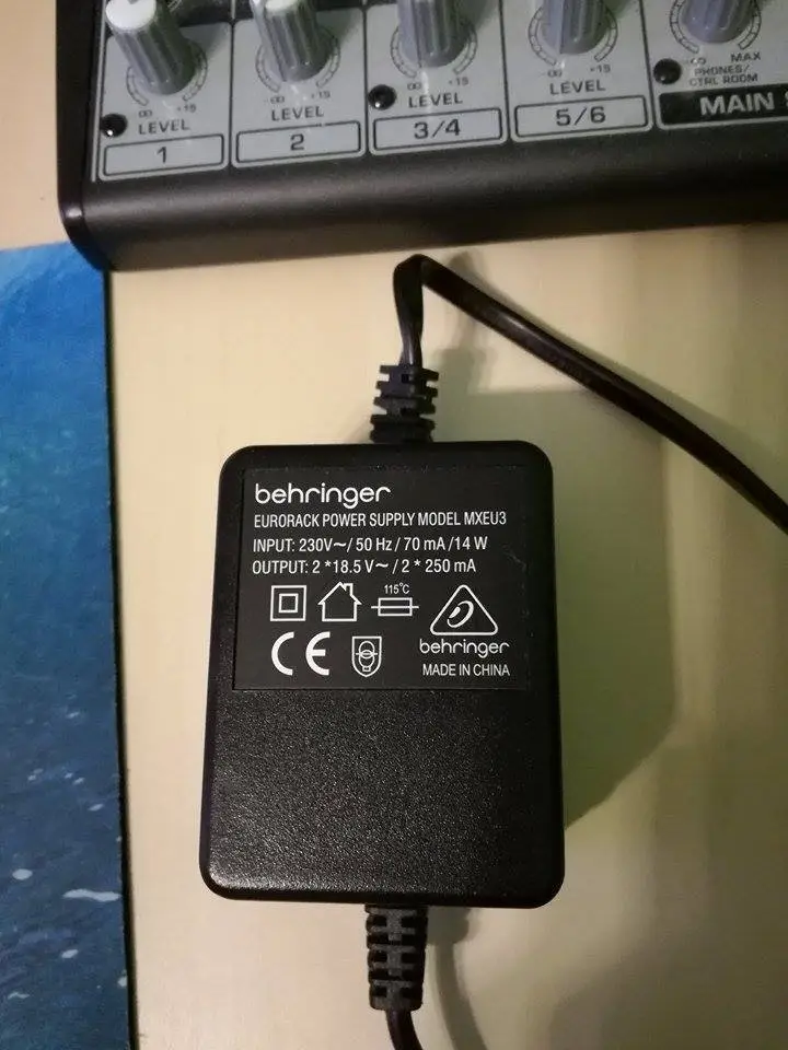

I can show you the Power supply for the Behringer

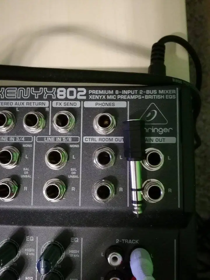

I also tried using the *PHONE* Port on the Behringer Mixer but didn't work out for me.

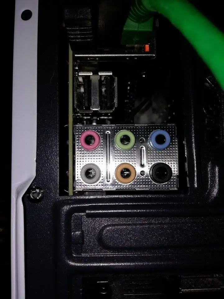

AND! i have a Question could anybody tell me which one of those *colorfull* Ports is the actual mic port at the back of my pc?
From a Google search....... different layout, but colors a the same. Blue one is usually called/considered 'Line In'
the computer connections you would use to hook up an 802 to a standard computer sound card goes like this:
2-track output (L/R) --> Blue (line in)
2-track input (L/R) ---> Green (line out)
Computer/monitor speakers connect to "Main Out" on the 802 mixer. The "ctrl room out" could be used alternatively, but it is the line out for the headphone amp. You could use this for monitors, and in this case, you would use a headphone distribution amp and attach the monitors to one of the headphone channels on that box.
