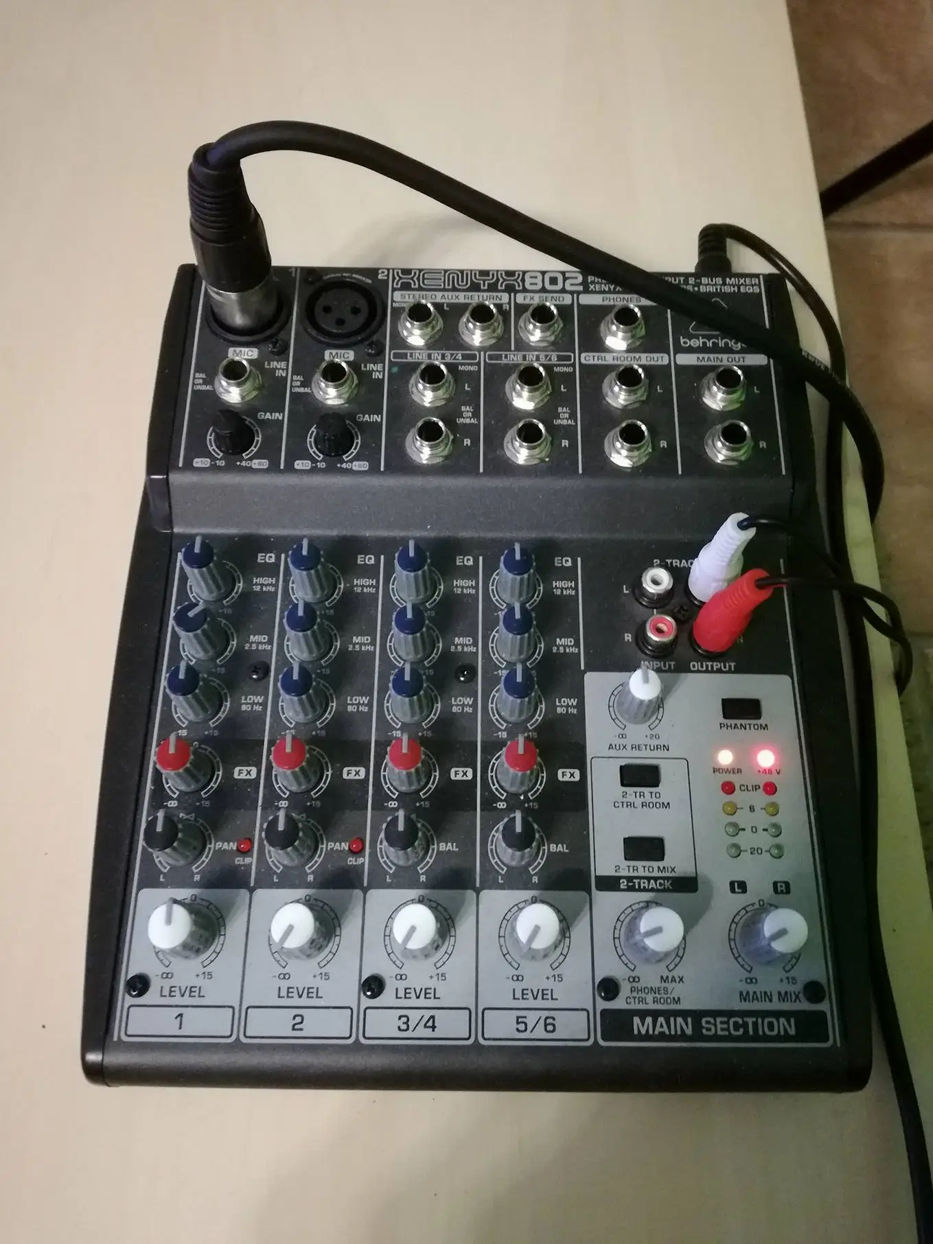

Hello everybody, my Problem is that i can't seem to fix the issue i have with the static sound coming from the Mic at every recording i do,
Sound File.
Vocaroo | Voice message

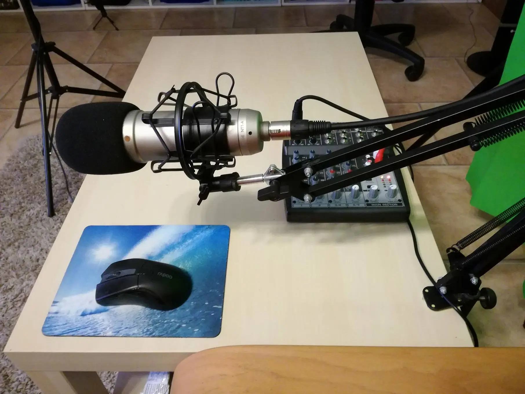

My setup is as followed , (Pictures).
22068929_1544721935584692_1660617288_o.webp22070202_1544721922251360_2048453917_o.webp22050471_1544721952251357_1241565709_o.webp
And in the End the external Soundcard goes via USB 3.0 into my PC.
and i am Using Audacity to record.
So any help is welcome on how to fix the static noise.

Hi,
The outputs you're taking from the mixer are unbalanced, so likely to pick up noise from surrounding equipment.
The fool proof approach is to get a USB audio interface (a real one) with balanced inputs, and use the balanced main outputs from the mixer,
but you might have some luck eliminating the noise by moving things around/turning things off.

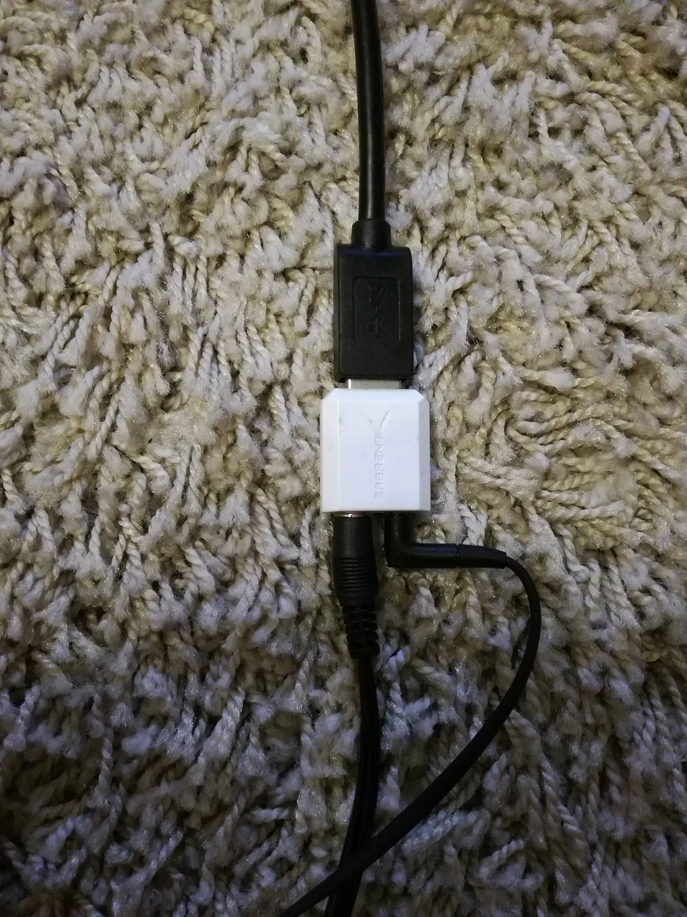

I'm not sure what you are calling the external soundcard, but maybe a couple questions to eliminate the usual suspects:
- What is that little white thing labeled Sabrent? (The only thing I could find online that looked like it said it took a mono microphone input! Is that why the Main level is almost "zero"? Where do you send both of the L-R outputs?)
- Does the sound change when you change the Gain or Level controls?
- Does the sound go away when you unplug the microphone from the mixer?
- Did you try a different microphone cable?
Offhand, I'd suspect that thing that looks like a sub $10 part trying to do the A/D conversion. You'd be better off with a real interface, as [MENTION=43272]Steenamaroo[/MENTION] suggests.

Second, Yes that small white thing is an External Audio Adapter *in Germany where i am from it is called Soundcard or Soundkarte*
You can even find it on Amazon for 8 Bucks i think. just search for Audio Adapter Sabrent
It is not the best but i bought it because it was recommended in a Video on Youtube on how to install the Rode NT1-A for beginners.

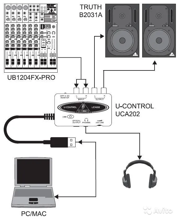

There's another cheap option to consider since you've got a mixer with the preamp and phantom power the mic needs, and that's Behringer's simple UCA202 adapter. It's about $30USD but I see used ones for a lot less. I used (and still have) the predecessor model and it works fine and quietly enough.
The mixer is sending a LINE LEVEL signal, while the Sabrent adapter is designed for a microphone level input. You've got both level and impedance mismatch there. It's not a matter of balanced/unbalanced (IMO) because it's a relatively short distance, but you could shorten the RCA cables, and remove one, since the Sabrent input is for MONO, not stereo. But, really, stop using that thing with the mixer output.
Another question - if you listen with headphones connected to only the mixer, and not connected to the "soundcard," then what you hear is quiet, with no background noise, right? I just want to rule out the mixer as a source of the problem.
I was also going to suggest the same. Gives a few more connection options than the Sabrent also.

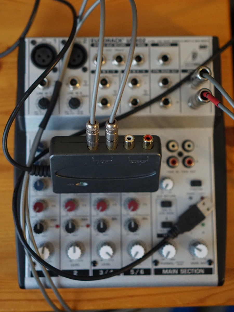

Ha. I went digging in the closet and found my setup from 10(+?) years ago (UB802 mixer & UCA200). Still works!

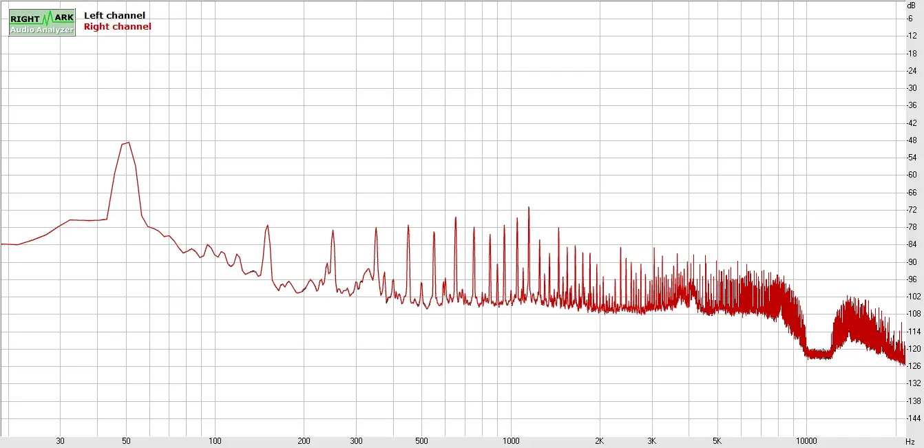

Oh! Brother have you got some hum on that!
Almost all 50Hz and some ~150Hz and harmonics (the rest is the converter crap from a crap USB converter) This smacks verily of TRANSFORMER coupled hum. WTF is the power supply for the Xenny mixer?
Wall rats and line lumps are notorious for spitting out hum, get it a good metre away from any audio cable or device.

Ok matey, pin back lugs, I have 'perimented!
First off. plugged UCA 202 into USB 2.0 port (HP i3 lappy) set for 'USB CODEC' and Samplitude Prox Silver played out Sgt Pepp' remix into my K92 boootifully.
Plugged 202 into 3 port and I had to re-set in Windows and Sam to get it to play but nay bother. Setup for record, again worked (wet finger test).
Next up the later UFO202 (has RIAA pre). Fine in 2.0 (had to restart SAM) but when I plugged it into USB 3.0 I got "Installing drivers" . I let W7 go through the whole lot including the Win update, too a few minutes but, again, after telling Windows what was what, fine.
So, IF you let Win do its thang it seems ON THIS LAPTOP, the 202s are cool for USB 3.0 but of course, we all know 'puters are finnikety bastards! However, if peeps out there ARE having issues I would bet a good percentage is lack of application to the minutia needed to setup most audio device?
N.B. I switched the UFO to RIAA and the noise came up (as expected) from -81dBFS to -55dBFS but with a good deal of induced 50Hz hum! The gizmo might be ok for dubbing vinyl but I for one would put it in an earthed steel box.
