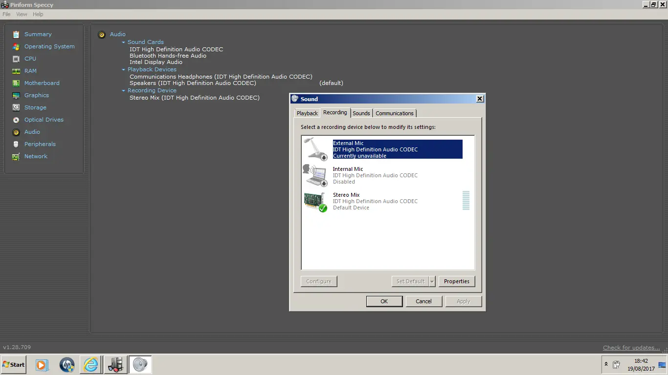

Attached is the internal sound recording system for this HP i3 laptop.
It is not, as you see, 'Realtek' but IDT Audio. Now that might be a peculiarity of the HP Motherboard or that Win 7 has move on from 'Realshit'?
There IS NO LINE INPUT! Just 'External Microphone' and if you want to feed line'ish levels* into it you need to crank the internal gain waaaay down! (note that my setup is for 'Stereo Mix'? This is so I can grab internet audio.)
I DO think you should be able to use that laptop again! ***t! son was using an EIGHT hundred MEG laptop with 500meg of ram and a 20G hard drive a few years ago! Worked fine with an M-Audio Fast track pro. Even gave pretty low latency from a dumb MIDI kbd!
I really do advise you to get an AI. Even the Behringer UCA-202 with a pedal works pretty well.
*Nothing hotter than neg ten mind! Err? Thought you said "absolutely NO hardware issues!"? What's with the 'wobbly jacks' then?
