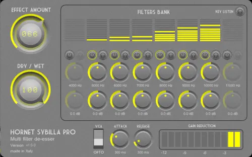

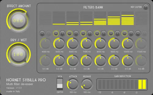

Good info on mics, but if you still are interested in a deesser that works well, take a look at Sybilla Pro by HoRNet Plugins. It's only 21.99€ (about $26).
Sybilla Pro, multi filter de-esser vst plugin

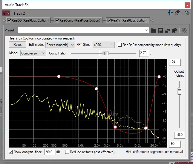

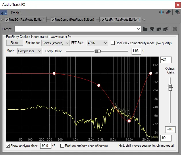

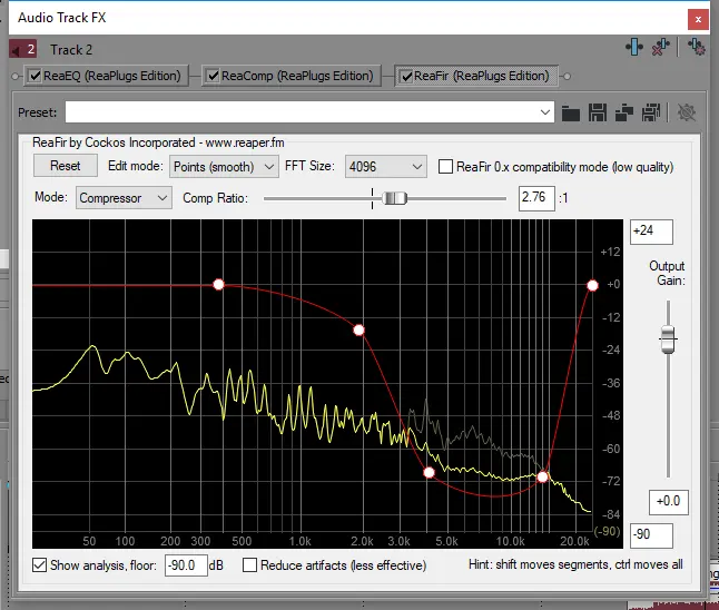

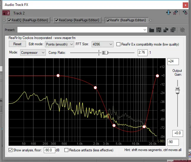

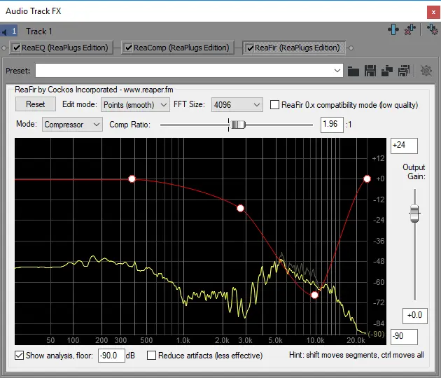

Not that it's all that important, but there are two main ways de-essing is done, band limited compression or full band compression with band limited detection.
The method I use is somewhat different from both: frequency sensitive compression, where only the frequencies that exceed a threshold curve are affected.
Not that it's all that important, but there are to main ways de-essing is done, band limited compression or full band compression with band limited detection.
I agree with you 100%. The point I failed to make is that the freqs must first be detected and than dealt with for either free or payed de-essers. I have always been taught that the less feqs affected on each side of the notch, the better the results. I think I will look into your method in more detail. It does make perfect sense that if compressed they would sound more natural maybe.
