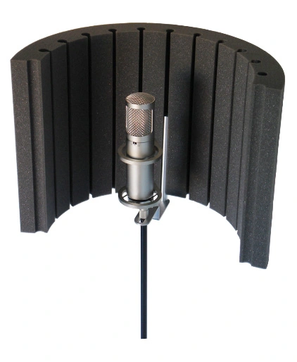

Any tips on what i should do with my room to make it better, sponge up the walls where my mic is being placed?
Alsoi was going through some acoustic treatment stuffs online and i came across this,
would it help?
Help? Yes. Ideal or close to awesomeness? Nope. Worth the money? Maybe, it depends on what kind of quality you are looking for.
The REAL sE Reflexion filters actually work darn well and I can heartily recommend them, particularly for vocals and the spoken word. On the other hand, the cheaper imitations I've heard reviewed tend to be not nearly so good and tend to do more harm than good to your sound. That picture looks like one of the knock-offs to me. Details of the real things HERE. I've used the "Pro" version and it was excellent. I've also used the Project Studio version which is probably about 80% as good for half the price. I've not tried the "IRF"....yet. Anyway, for vocal recording they're darn good (but don't help with the room acoustics if you decide to mix yourself using monitors.
As for what you need, I'd probably add a pop filter to your kit. I'd also suggest a set of monitors to your wish list when you can afford them.
