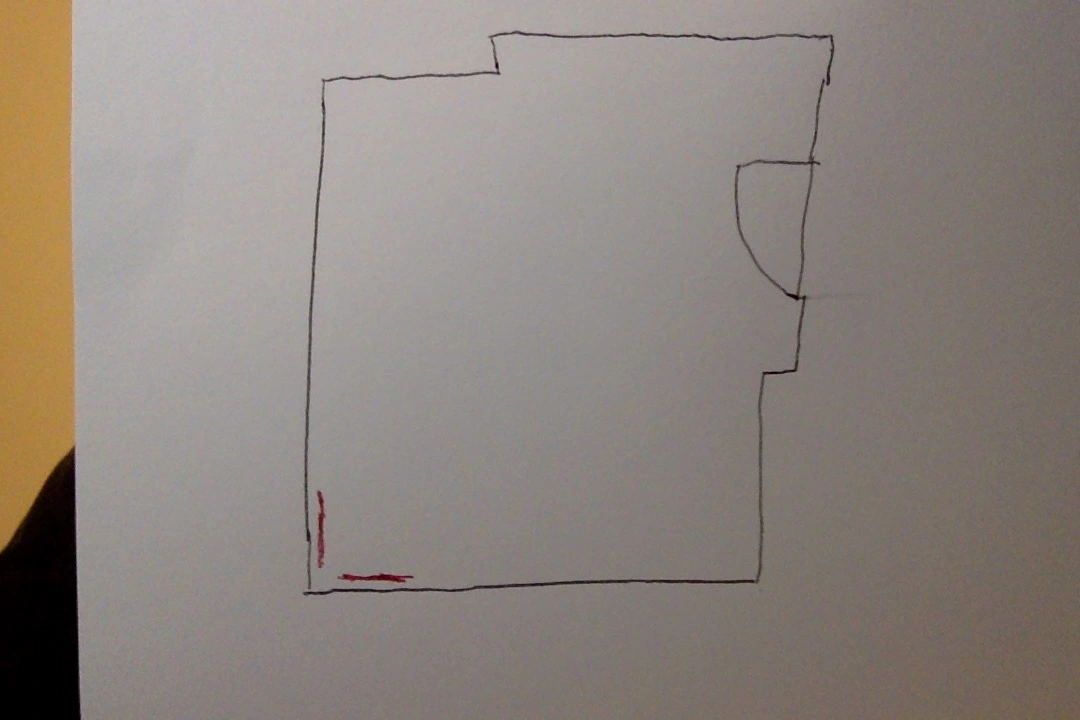

I need to create a space where I can record vocals. No instrument, nothing, only a singer facing a mic.
I have this room in my house that also needs to serve as an office. I have tried recording on it, and it's terrible because walls are concrete on one side, plasterboard on the other, with no acoustic treatment whatsoever. So the echo is terrible.
I need to treat the room so that there is much less echo.
My current idea is to make the bottom left corner of the room a sort of open voice booth. I have low DIY skills, so I am trying to go for a simple solution.
My plan is to buy two bass traps, one on the corner in the floor, one on the corner in the ceiling (found some at like 15 GBP on amazon)
Then put 2 or 3 plaques of acoustic panels on each of the 2 walls, close to the corner (found some packs not too expensive on amazon)
I also use a semi-sphere of foam directly placed on the mic stand (though I am not sure how much this helps).
Does that make any sense ? Is it just hopeless to leave everything else untreated ? I could probably put more acoustic panels on the other walls, but I hear that bass traps are the most important, and I think it will become very unsightly for the office to have too many bass traps.
Is there a better idea ?
Thanks !

I would offer that for a given amount of panels 1" fiber -not foam min, 2 or more inches better, you are always better hanging or mounting them around you and the mic -away from a corner.
Three sides of the typical 2'x4' for example up and relatively close around you can do a lot. One above if you can manage it tackles the remaining worst close hard reflection (unless you have quite high ceilings.
I've done temporary setups hanging them off mic stands for example then raising them up to get an effective height.

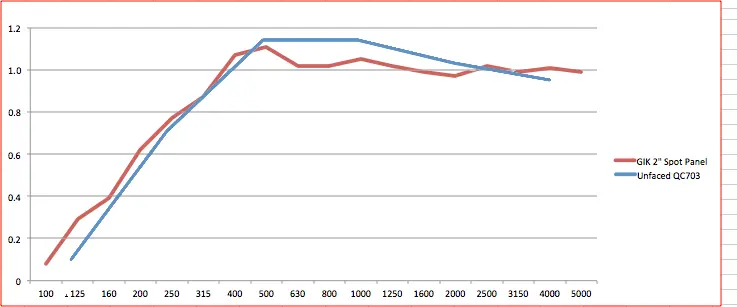

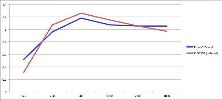

The graph doesn't look horrible, but if you expect to record baritone or lower vocals you probably want something a little denser or thicker.
I attached a couple plots of 2" OC703 (unfaced) and the GIK 2" panel, which I believer are made from one of the OC703 flavors. You can see that they also start to drop off below 400Hz. If you need more low frequency control in the room, you'll want to look at thicker/denser material, or ones called bass traps.

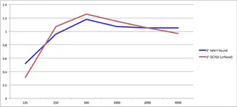

P.S. To show how density improves bass absorption, here's 3" OC703 and Rockwool Safe'n'Sound plots.They start out better at 125Hz and increase more rapidly. You can see OC703 specs here:
https://dcpd6wotaa0mb.cloudfront.ne...lation-Product-Data-Sheet.pdf?v=1582773799000

Thanks for that, that's really useful. I ended up buying bass traps. I read online that voice frequency is 80 Hz to 180 Hz, so it seemed indeed the most important part of the spectrum.
That's like the low E on a guitar, up to not-quite middle C. Voices can go a lot higher, and it s the harmonic content that makes a voice sound like it does.
Yeah, what [MENTION=39487]mjbphotos[/MENTION] said. That's really the very bottom of the bass[o] range, not your typical singer. Unless it's a bass voice (like I noted earlier), broadband trapping is probably enough. Bass traps, assuming made from the same material, tend to be just bigger and thicker, often tall for corner applications. But, if you got flat panels, they will also be quite effective for use on the sides and overhead for early reflections, so long as they can be safely mounted.

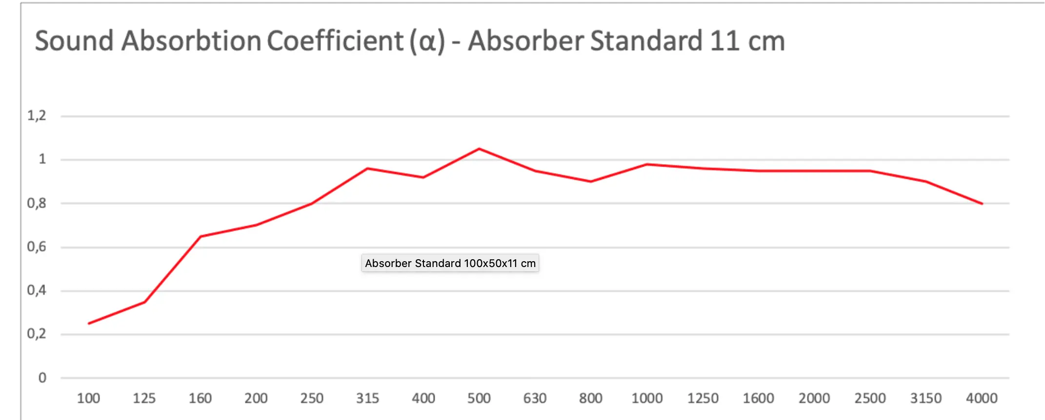

Thanks that all makes sense. In my specific case, most of what I will record are a male voice, just talking. So I think it will stay in the low ranges. have purchased bass traps that have a coefficient of noise reduction above 1 across the spectrum. So it seems pretty good and fairly cheap (downside is that it's 30 cm thick, and really only goes in corners. It would be good if I found a broadband trap that is in the form of a panel, to hang on the wall, but I haven't found one that has a coefficient of noise reduction above 1 at the low frequency.
So I'll start testing with just the bass traps when I receive them and see how it goes.
Very cool! Thanks for the pic. What are the noise reduction factors of the panels you used, for each frequency range?
