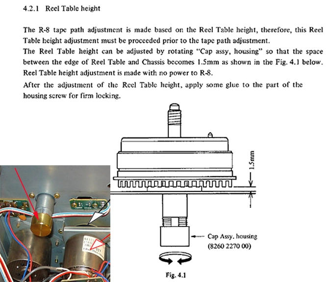

Hi,
I'm trying to adjust the reel table height on a Fostex R8 but I can't rotate the cup.Tried with a soldering iron to melt the glue n the housing screw then with pliers with no luck. Any ideas how to do that?
thanks

Sorry,SpirosG. That attached image, and Fig 4 doesn't make any sense to me. Is there some component missing, from the views?
I'm not familiar with that Model.
Maybe use some small vice grip pliers? I know you hate to force it, but that is not a user friendly design.
Are you sure the reel table height needs adjusting & there's not some other solution?
:spank::eek:;)
You should not ever need to adjust this. But if you really have to then try applying some pure acetone or acetone based nail polish remover, use q-tip swab and apply all around to soak the old "paint-glue", let it sit for a minute, it should get softer.
btw, there's nothing missing there :)
