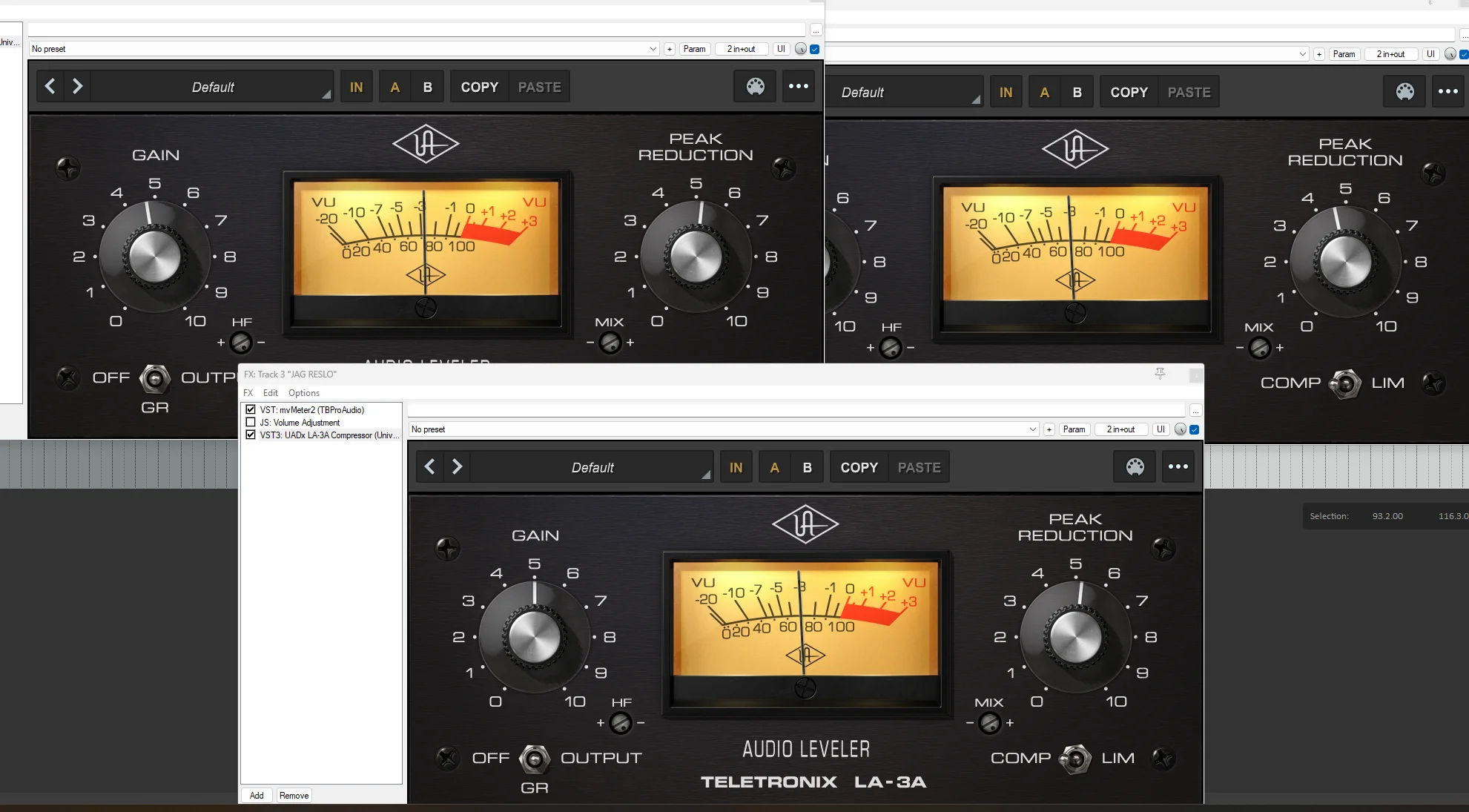

LA-3A Audio Leveler (Each guitar track the UV meter reads -3 and on the master its -1 uv)
Reaper DAW
My meter2 UV meter and it reads about 0 on the master and on the main buss with the reference level about -14

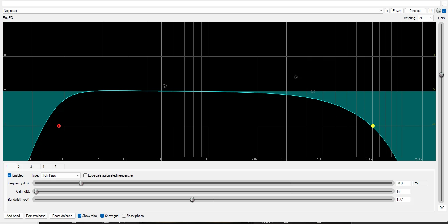

ReaEQ for cutting high frequencies above >10k and low under>90

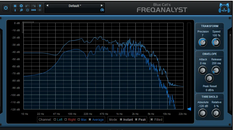

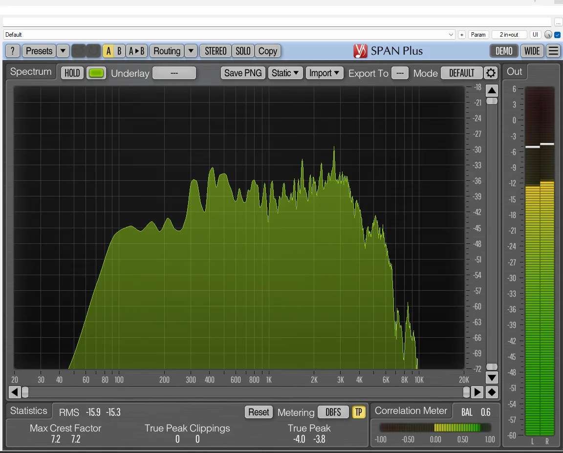

Here is what SPAN Plus reads also
Pretty much the usual choice is that if you want a sound for any instrument to be the same on speakers and small devices, you have to mix for the feebler one. That means some eq and treatment choices must be constrained within areas they both can manage. Michael jackson’s Billy Jean was a good example when it came out. On laptops and small radios at the time, the bass part almost vanished. Not totally because there is a fair amount of harmonics on the bass that dont completely vanish.
Your guitar sound is quite solid at the bottom, and if you lose that it suffers. I doubt anything you can do will help that much because of the way the guitar part uses those bottom strings? Plus it is doubled with almost identical more distorted guitar in the same area. Have you tried the original on the same devices?
