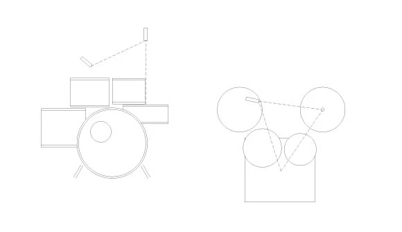

still would like to see a diagram or pic of this method for those of us who are a little more visual.
is this right?

i dont know if this is correct. this is just my interpretation. can anyone tell me if it is correct?
Definetly think you are on the right track. You could always give it a try
