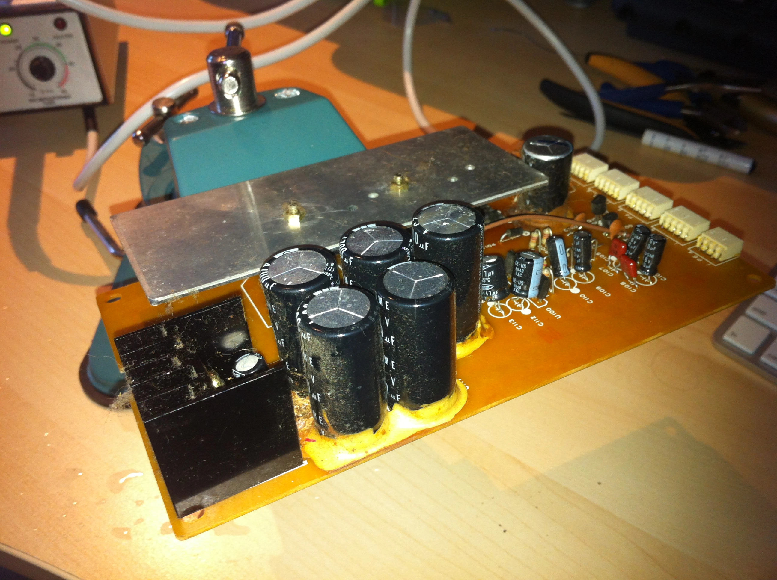

Today I received my Tascam 388 in the post from a seller in Perth. It arrived in good condition in a very nice road case.
The 388 itself has some issues. The first one I've dealt with already as I had a day at my disposal and decided to get cracking and re-cap the power supply before attempting to power it up.
Before: (yuck)

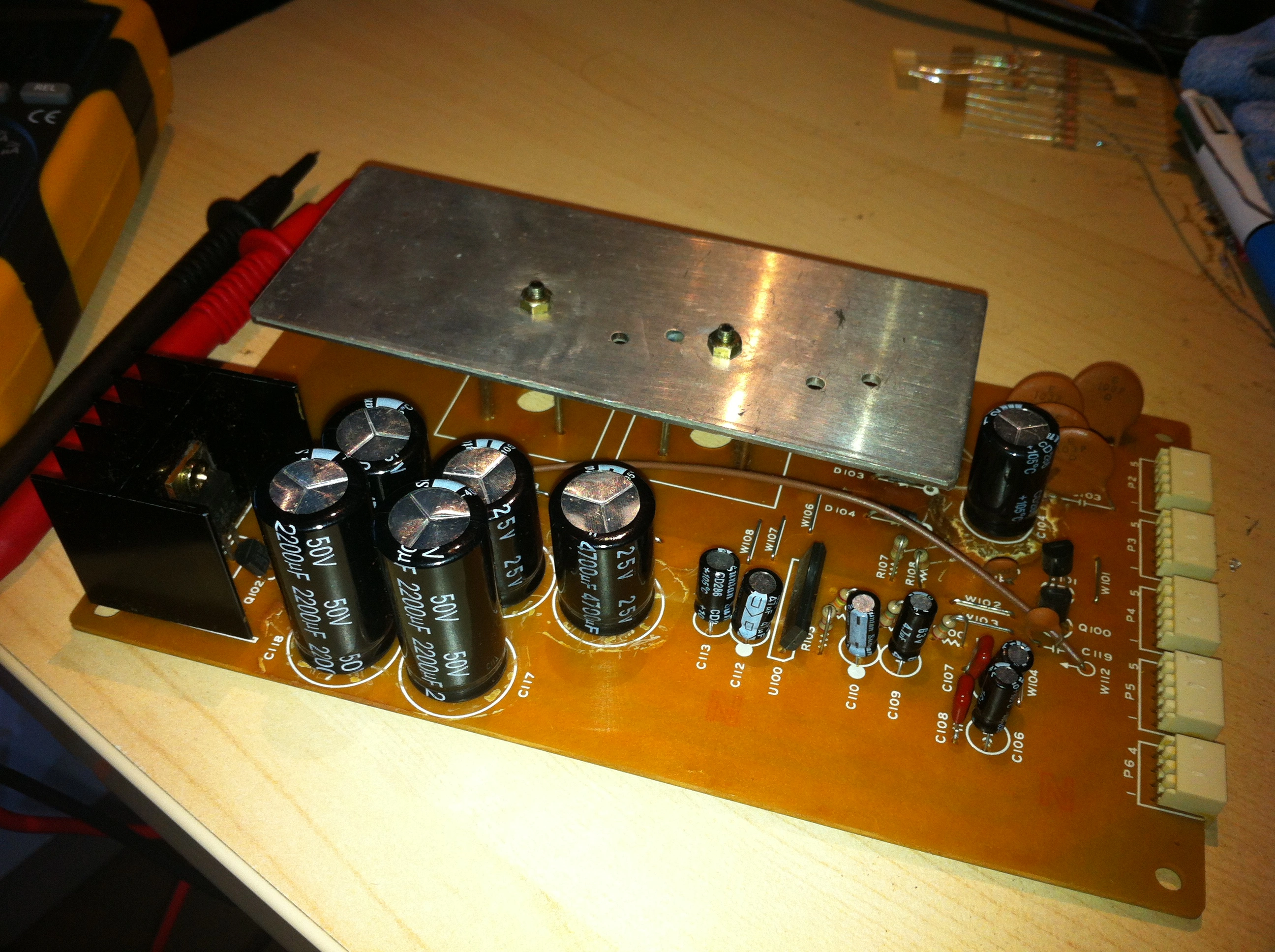

After:
Power supply now works a treat.
