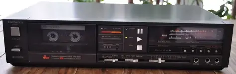

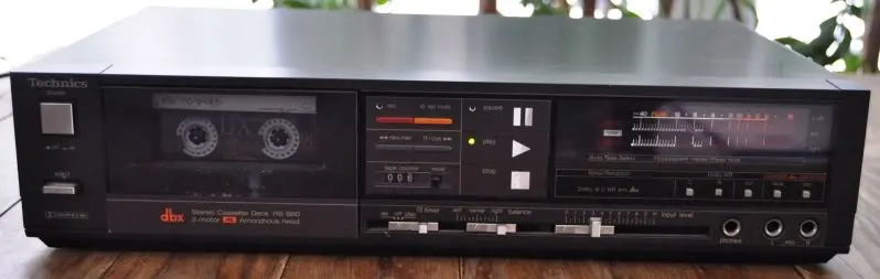

the Technics RS-B48 & RS-B50 (pictured) are quite decent and affordable.
:spank::eek:;)

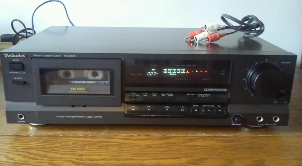

Much easier to find is...
the Technics RS-B465. Very decent for the money.
