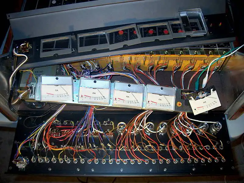

Curiosity got the best of me!!!!
Ok,... here's the update. After finishing my beer and doing all the most basic things over and over again, I got the ol' screwdriver out and popped apart the entire M-35 meter bridge, mounting plate and everything, so I have 4 meters basically floating and Meter #1 in hand. I cut the sealing tape and pulled it apart. !!!
FIRST, the "zero-point" adjustment on the front is not a pot or inductor at all. It's a screw-top adjustment with an eccentric tit on it, which mechanically adjusts the "zero point" or "fine mechanical" adjustment of the needle. That's why when you turn it thru repeated revolutions, the needle goes up-then-down, as that's the entire sweep of the eccentric tit on the mechanical adjustment.
OKAY: I've never had the opportunity until now to say "eccentric tit" in any post, but I mentioned it twice since they usually come in pairs.
:eek:
NEXT: with the unit in an unplugged, disassembled state, I hooked the standalone test signal to the meter, and when I dicker with the positional adjusment on the front, it will hit a spot where the "static/bouning" thing takes hold again. Also, when previously testing the meter with it entirely assembled and the test signal hooked to the lugs, kind of depending on how I would hold or flex the lugs I might get a momentary "bounce". HOWEVER, internally to this meter it looks like mylar-flex-trace connections internally to the actual coil, with no discrete wires or sizeable connections to do anything with at all.
THE GOOD NEWS, is that the VU "faceplate" is a card that's glued on with 2 spots of glue at the bottom. I believe I can work loose and remove this faceplate card with the hole in it. ON the backing plate of the meter is a larger diameter hole, that the faceplate card goes over to succinctly locate onto the OL-LED. SO, I believe at this time I can get the new/replacement meter, remove the card on it, drill a gross/adequately located hole in the backing plate, and use the original faceplate/card to restore the meter to near-original and functional condition!
I really like this mixer, tho having it for many years and not having a chance to use it properly, but after putting so much effort into it I have to keep it and make sure to use it. Either that, or the selling price goes up dramatically, maybe $75 more than currently listed. $36 meter, plus shipping, and an assload of effort to restore that 1 funky meter. $75 bump is fair. Anyway, I'll need something left over to eventually revive my recording "career", and I've always liked having a diversity of equipment around. (I already sold my M312, in the process of selling most of the M30's I have on hand).
There are no user servicable parts inside this meter, as my friend succinctly stated above, but I now have a solid plan to revive this mixer in general, calibration further down the road TBA. Once I have the replacement meter worked up and installed/workng properly, I'll tear down into the guts of the bad meter just for fun. Pain in the Ass, is what it is!
