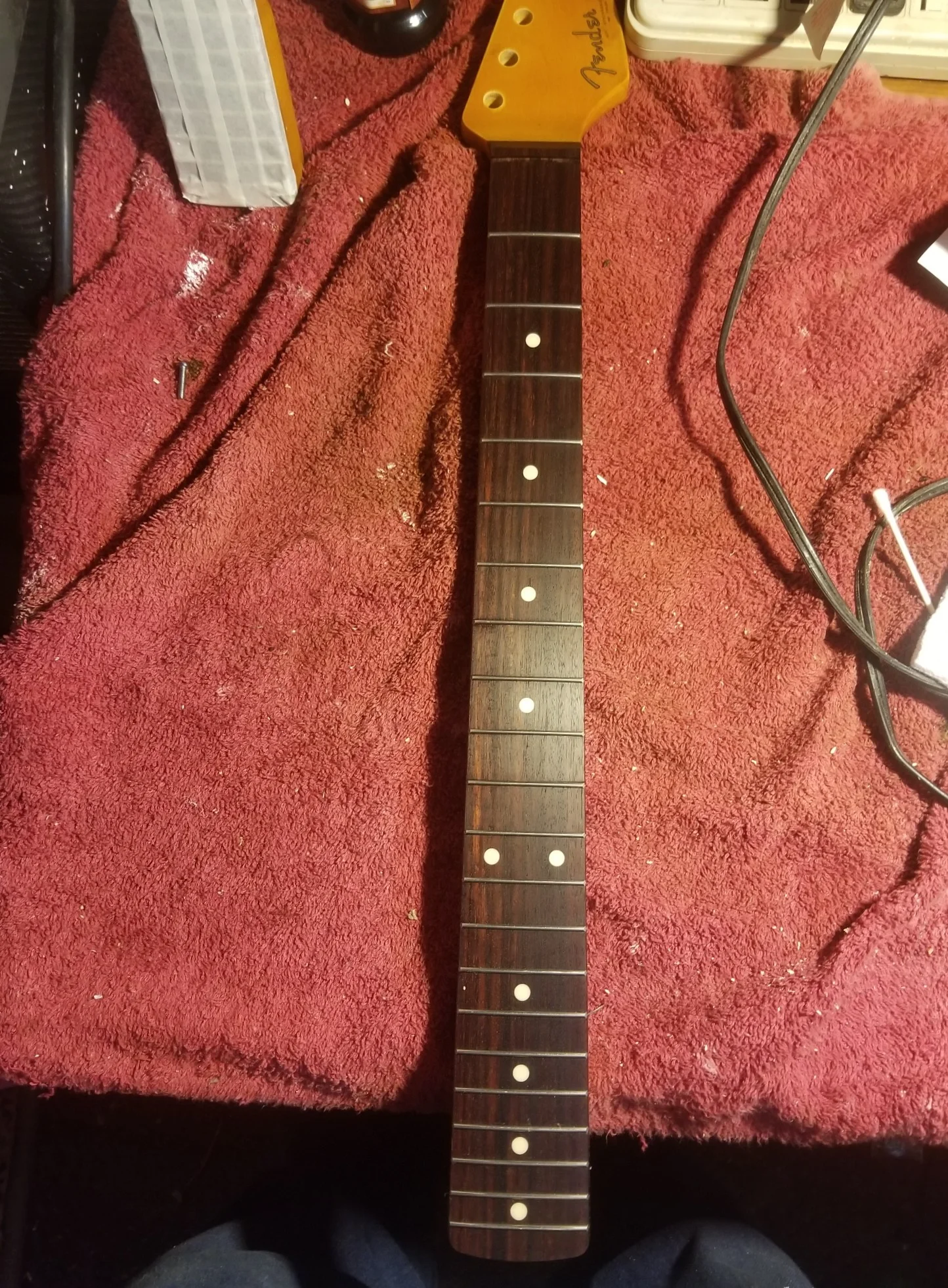

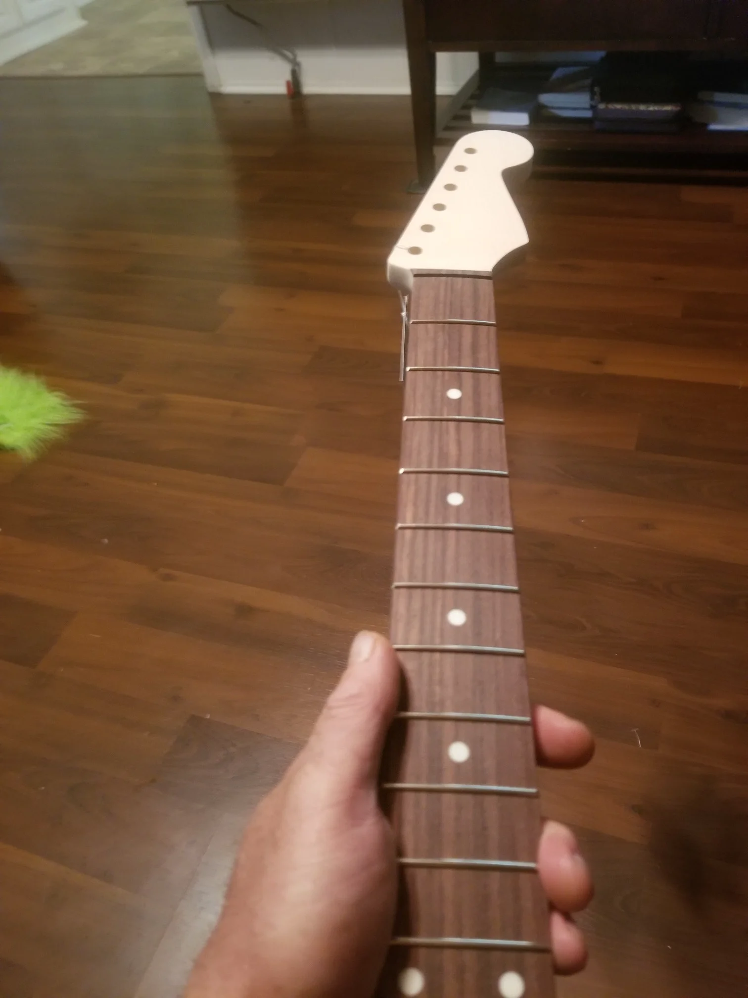

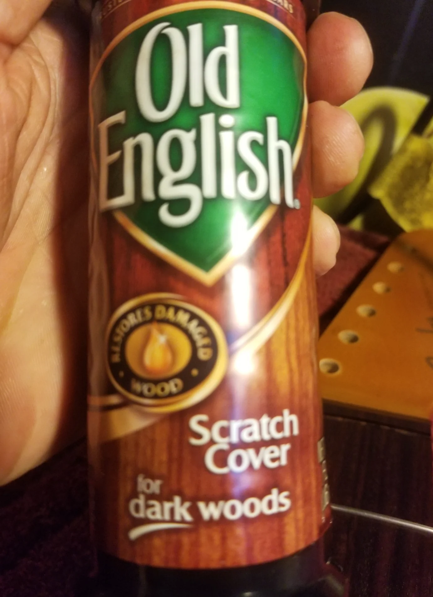

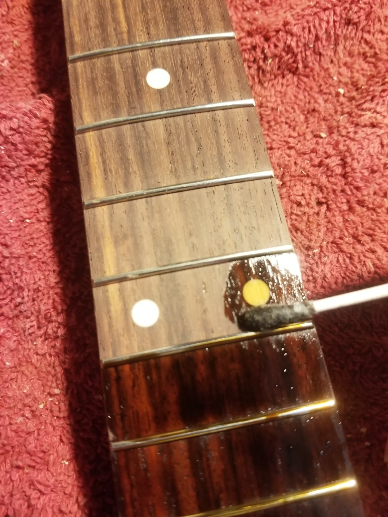

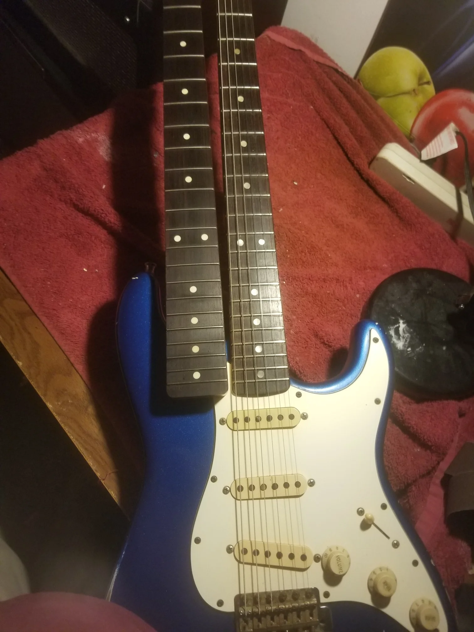

One of the most amazing products I have used on fretboards is Old English dark furniture scratch repair. You can take those light anemic looking modern rosewood fretboards and take a q-tip, wipe it on, let it sit a while, and then wipe it off, and the results are stunning. All the grain nuances are still there but the fretboard is several shades darker. It dosen't end up coming off on your fingers from playing and it never wears off the fretboard. Also, it doesn't color anything that is not wood, like mother of pearl, Ivory, pearloid dots, or plastic inlays at all.
I treated a pale strat and tele neck for a couple of partscaster projects. Here are some pics and a comparison side by side with my 66 strat Brazilian board.
