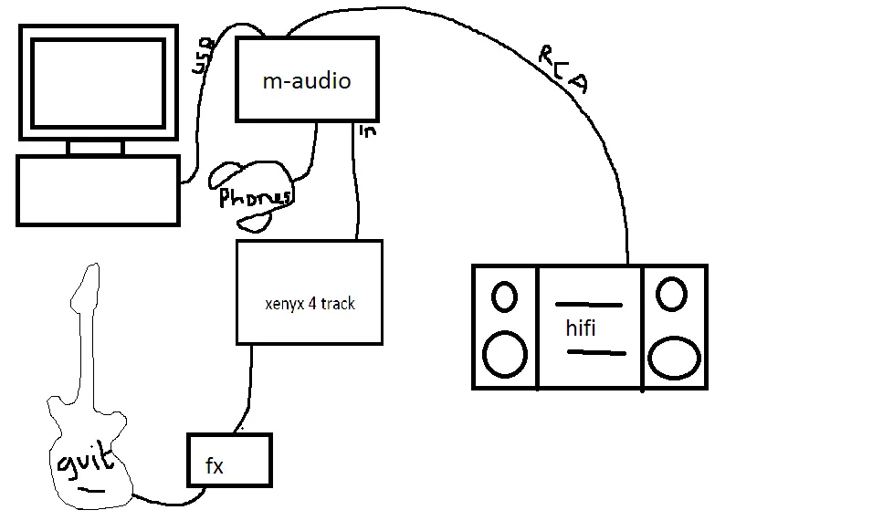

Ideally an audio interface with a built in pre amp would do the job, other than this you won't get a good sound without pre amp for the guitar, so i guess you would have to use the xenyx mixer you have into the audio interface to get a decent signal. Why do you run RCA from the interface to the mixer though? I would run the cables from the RCA output on the interface to some monitors (or just a hifi if money is tight, as it is for me!) and use the headphone socket on the interface for phones. I have a behringer analogue mixer and a novation nio 2/4 interface, I've used the behringer a couple of times for mic'ing things that need more than two inputs and the degradation in sound quality is pretty noticeable. Never used the tape in/out ports though. --
I read this back and it made no sense, here is a nice little picture! -
Ahhh, I see what you are doing there. I may just route my outputs from the M-Audio to my speaker systems (Going to invest in some good monitors here soon) since it has a aux input on them.
The only reason I was sending the output from the m-audio was so I can could hear the drum tracks through my headphones. There are two switches for the CD/TAPE, on is CD/TAPE to Phones and CD/TAPE to Mix. If I add it too the mix then I in a way get a echo of everything through my mixer, but if I send it through the phones it just routes the audio coming from Pro Tools (drum tracks, ect) to my headphones so I can play along with it.
