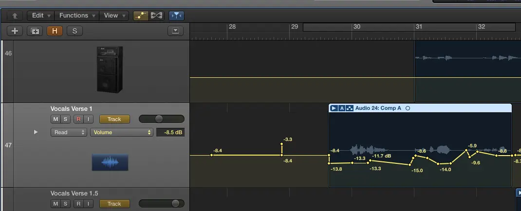

In regards to enveloping, is this what you meant?

Any view on my interpretation of enveloping? Basically when I increase and decrease the automation I am creating an envelope. A dynamic change in volume?
..Any view on my interpretation of enveloping? Basically when I increase and decrease the automation I am creating an envelope. A dynamic change in volume?
Yes, your screen shot and the other two examples that were posted..
It's not a verb but.. yeah :D
