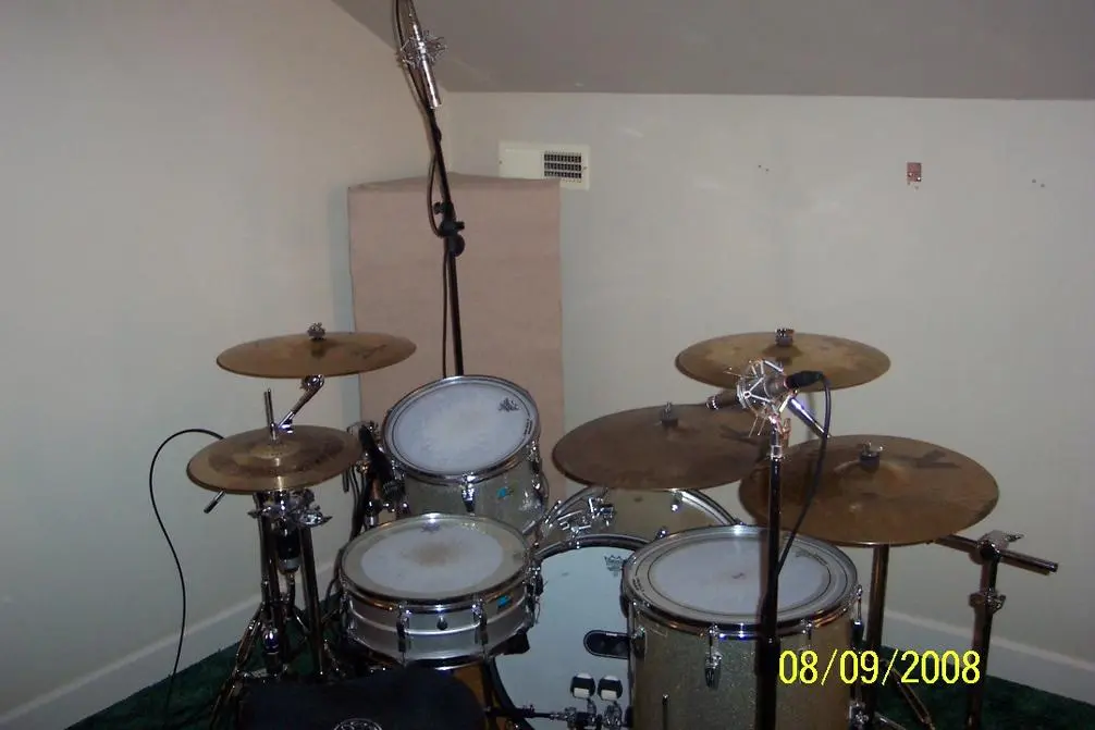

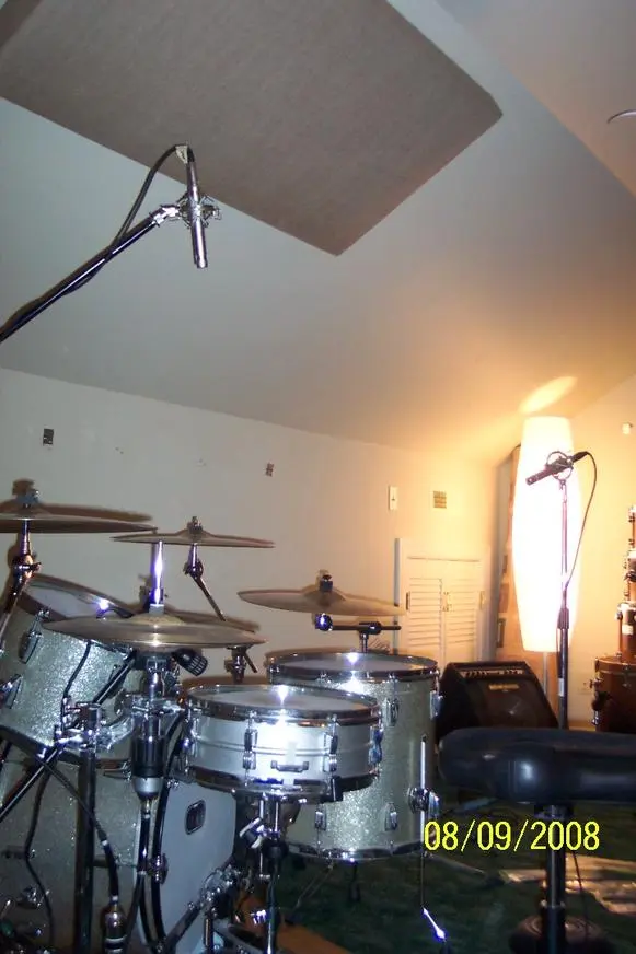

I really dont think its a prob with your mics......but its a problem with your levels. What is your recording chain? I am a minimalist as well. Peluso CEMC6 overheads...Audix I5 on snare.. EV ND868 on kick. Thats it. I hear my toms just as good as everthing else. I use recorder man method/Glyn J...method. One sec and I will post a pic if that helps. Why? Cos' I am bored and drunk.

Word! Here ya go....
