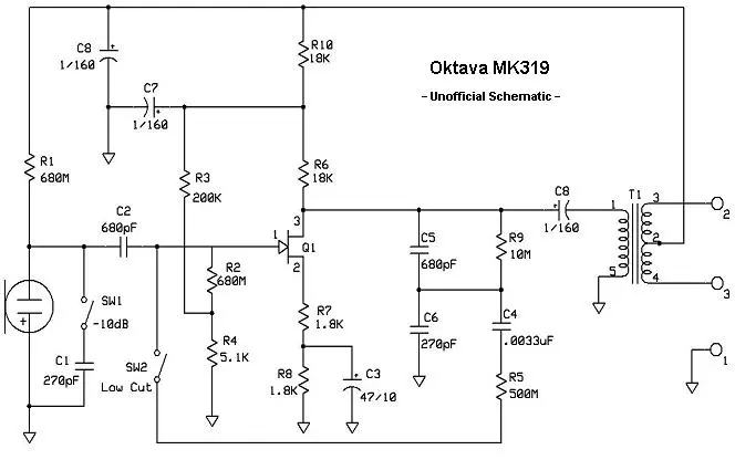

I swapped out the capsule capacitor for a polystyrene and removed the plastic high frequency disc that's bolted in front of the diaphram. This made the top end a little more natural in my opinion.
I quoted this to remind me to do this mod. If the original poster could elaborate a bit more on this for me, particularly about the capacitor, I would appreciate that very much. Thanks
by making the top end more "natural" is being brought out more or less than before? this is a darker mic as it is. i hear taking out the disk makes it even darker from some people and i hear that it brings out the high end and makes it more crisp and clear from others.
See the schematic below. I replaced C2 with this part from Mouser Electronics. I think other's have replaced or bypassed some of the other caps, but I haven't tried it.
The HF disc removal is pretty self explanatory once you see it in person. Just unscrew the 6-8 screws holding it in place on the outside rim.
The last thing I did was take a big honking soldering iron and removed the inner layer of mesh screening
EDIT: Thanks to Flatpicker (I think) for the schem
