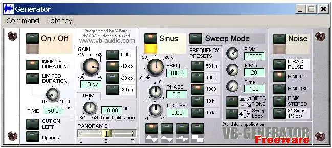

You may want to directly download a free test tone generator from here:
http://vincent.burel.free.fr/download/generator_standalone2.zip
It's excellent and has lots of features but is easy to use. Has presets or could be dialed in to whatever you want.
I just burned about a minute of each of the following tones onto CDR (to copy the Fostex TT-15): 40Hz, 400Hz, 1k, 10k and 15k.
If you have a quality soundcard then I guess you could do it from your pc as well. ;)

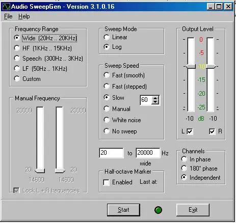

The “a” suffix on MRL 21J303a is to differentiate the newer tapes from the older ones mentioned above, so you have the right one.
You can generate test tones from your PC. For the 1kHz operating level it’s handier to buy a pocket size tone oscillator, like the Fostex TT-15 or TEAC TO-122a. I see them quite often on eBay.
The dedicated tone oscillators are precisely set and switchable for standard levels such as -10 dB and 0 dB… 316 mV and 775 mV, respectively. The 1 kHz operating level tone must be a precise value.
Using your computer you would need to adjust the output level. Not all sound cards are the same. Even if you have an oscillator program set at -10 dB, what is really coming out of the sound card depends on its nominal output level.
For setting input/output levels (not flux levels) you would need to adjust the PC oscillator. To do this, generate a 1kHz tone while measuring for the correct output voltage with a multi-meter that can measure mV (milivolts).
The connection goes from the line-out (or speaker out if no separate line-out) on the sound card to the input of the recorder. You can buy a stereo miniplug-to-RCA Y-cable adaptor from Radio Shack. You only use one line, either left or right from the stereo output.
The 20Hz to 20kHz sweep is for checking crosstalk between tracks on the Model 80 and R8. Fostex has a rather unusual way of doing it. It’s normally measured with a single tone.
There are free oscillator programs on the web you could use for the 1k tone and the 20Hz to 20kHz sweep, such as SweepGen below.
http://www.david-taylor.pwp.blueyonder.co.uk/software/audio.html
~Tim

Btw, here's what the screen shot looks like of the test generator from the link I gave.
