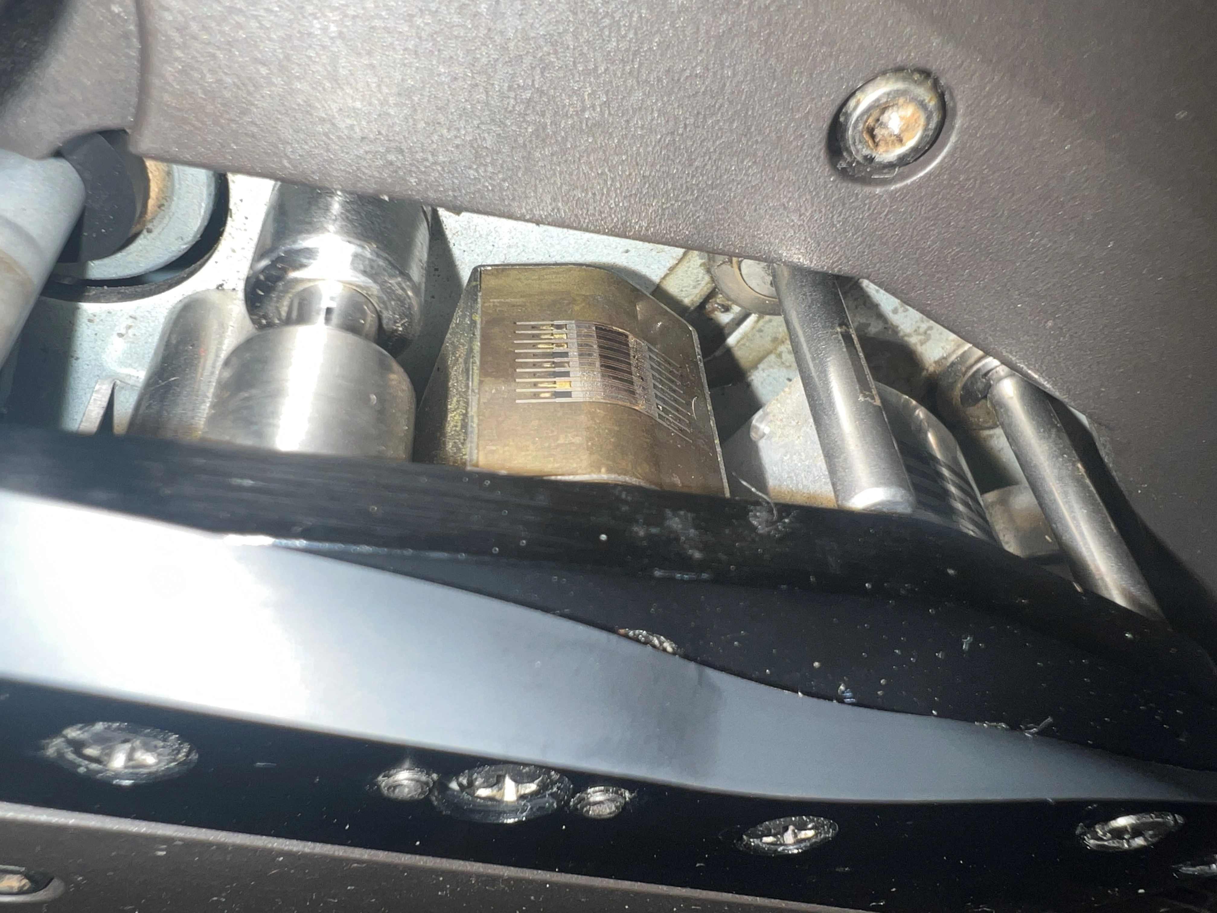

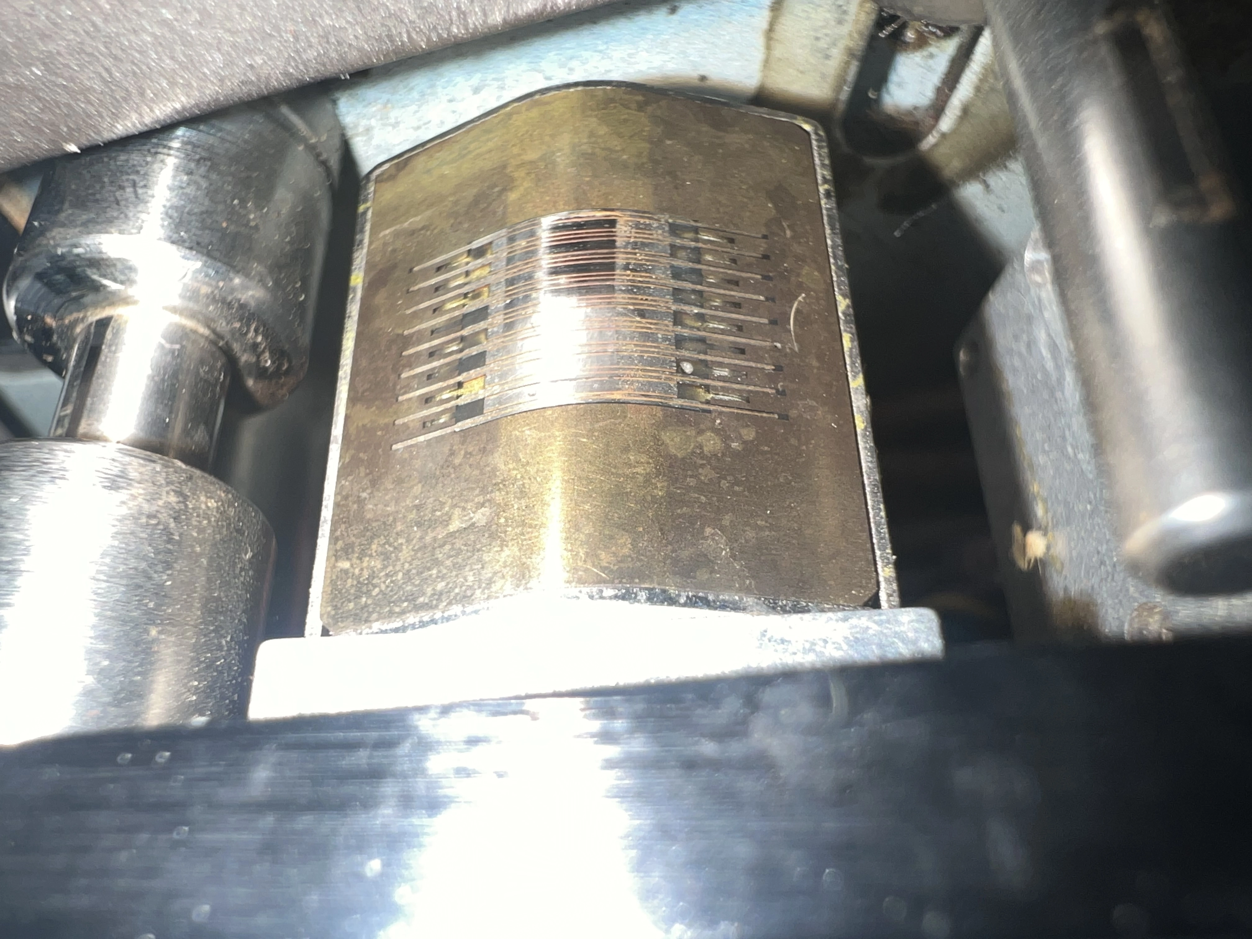

Can you post a couple good pics of the R/P head?

Hey sorry about the delayed response, got busy before I could test again. So I put a different roll of tape on that I have, still don’t know exact what it is, and I applied pressure upwards on the tape as it ran across the head and the issue is still happening. To be more specific about the sound, it’s a crackling and popping noise along with the recorded signal, with some fluctuations in volume. I’ve uploaded some photos of the R/P head below.
