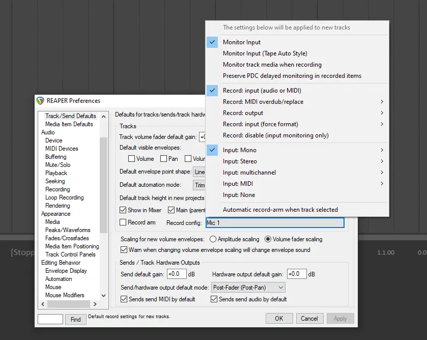

In most DAWs, you can turn off input monitoring, either on the individual track or globally. To do it globally in Reaper, you go to Options -> Preferences -> Track/Send Defaults -> Record config.
