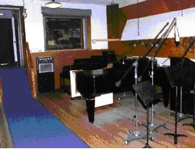

yeah check out Motown. Hitsville... a couple good tunes done here..:D
