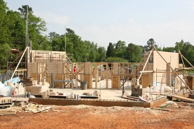

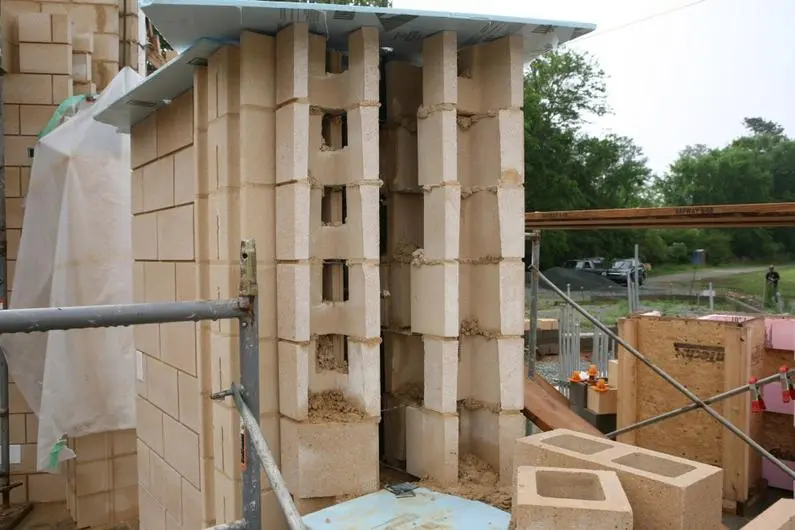

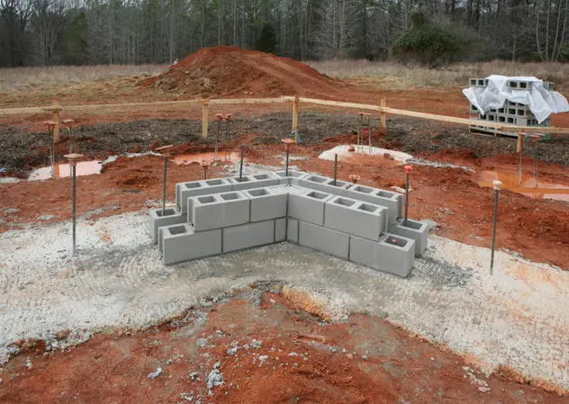

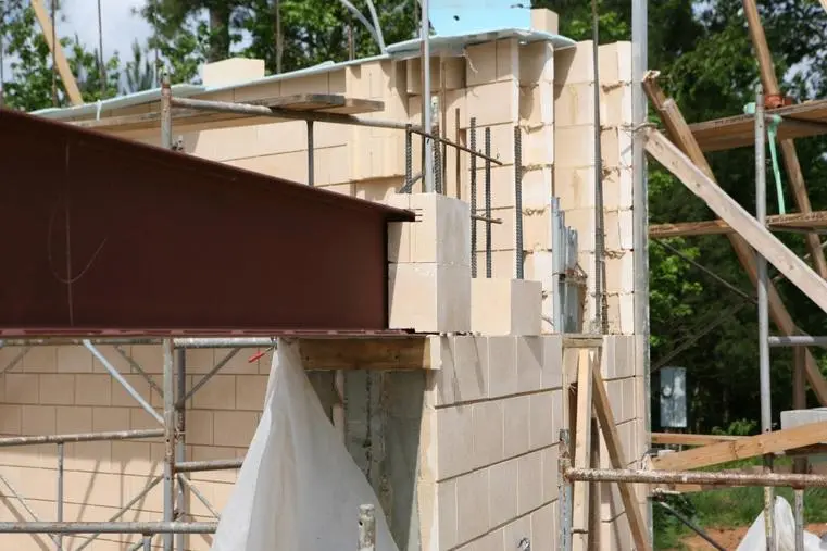

btw, just be glad you don't need this kind of iso.:D Check these out. Thiese are a few of the construction photos for Manifold Studios. These are the the bond beam above the control room window. DOUBLE WALL MASONRYaround a steel I beam.:eek::eek: can you imagine what this cost?:eek::rolleyes::D
You can see the whole thing here:eek::eek::eek::eek::eek::eek::eek::eek: Absolutely astounding! Look at the FOOTING WIDTH in the last picture. That will illustrate my earlier point perfectly.
http://blog.miraverse.com/?p=580#more-580
This assembly must have a TL rating of 1000:)
