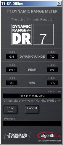

I would guess that your monitoring setup is bass heavy because the mixes seem lacking in lows and a bit brash in the highs. Also, both tracks are mastered really loud and are clipping quite a bit.

I'm curious how you ended up with such a loud track. Is that just how you mixed it or do you do some kind of main bus processing or do you master the track as a separate step? Is there an overall eq anywhere in there?
that was me pushing a limiter too hard, that's all. Its more dynamic when softer and not pushing so hard, I'm just wondering how in the world to get the harshess out of the 2-5k without it sounding dull. I have no clue
