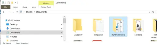

Windows tries to protect you from writing files into the root directory. People tended to screw up the operating system by dumping stuff into inappropriate places. That's why you got the warning. (You can do it, just ignore the warning). But there's a better place to work.
You should have a "DOCUMENTS" folder on your computer. I made a folder in DOCUMENTS called REAPER MEDIA
Reaper Media Folder.jpg.
This is where I can put all my work files. So, if I am working on a recording of a "Jam Session Aug 29", you will find a folder there with that name. I will copy the ENTIRE Audio folder from the SD card to that folder on the hard drive. That is where I do my work. It keeps you organized and you can immediately find you various recordings in one place. It also keeps your SD card safe. Pull the SD card and put it away.
Also, the comment about "not having anything on the right side" is because it takes a bit a time for Reaper to create the image of the wave form. Since you have got tracks showing, you should now see an equal bunch of files with the extension of "REAPEAKS". For long sessions, it takes a longer time to paint the picture of each track. If you are working on the SD card, its much slower than the hard drive, so that just makes the process take longer. Thats another reason to use the hard drive. Once those are created, it will keep those files updated.
