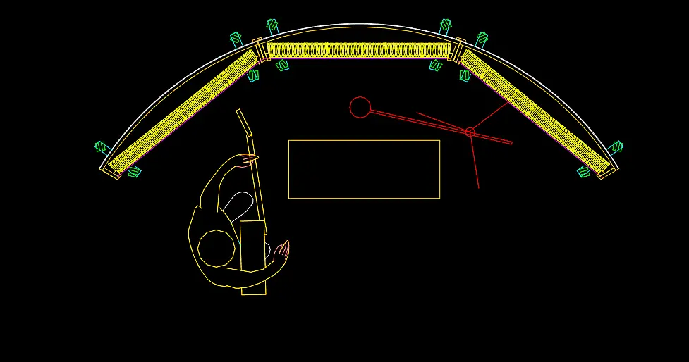

I would make them 5" deep 4' wide x 6' high. 3/4" Birch ply frames, with 3 layers 1/4" ply backs with 1/8" steel plate on the exterior, CURVED with 72" radius. Line with 4" 703 and fabric covered faces. Add casters and edge latches for fastening multiple units together.
Well, you asked. :D

Hey fitZ.............
Doesn't that poor man's arms ever get tired?!?
I've never seen him move his arms from that position. :p ;) :D :rolleyes:
I pay him. He's never late, hes consistant, never bitches. Never even takes a break...I like that :D
fitZ
ps, I guess I better draw some others. Inserting this one is so damn easy though.
Actually, after I drew these, I realized I drew them wrong. They SHOULD be a two leaf system for good isolation qualities, but the curved steel plate was an afterthought for one leaf mass. And then again, as far as low frequencies are concerned, they will simply defract around the gobos.

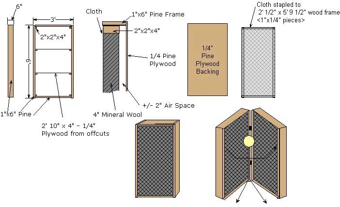

This is what I did and it worked out great for me.
After looking back at your question, I'm not sure what your using it for. It almost sounds like you are looking for sound proofing from this. Is that the case? (hope not)
well, I want to give the drums a drier sound, and also hopefully pick up less of hte band in the overheads and snare mic.
Ok, well then it should help. Just make two of what I have shown above and it should work out fine.

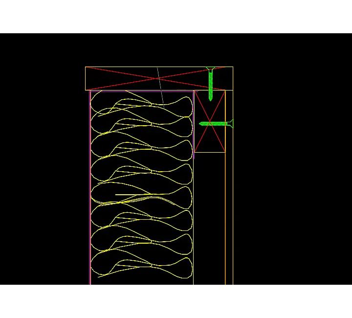

There are a dozen ways to do this. Falken, get yourself a few 3/4" x 1 1/2" pieces of wood from HD, cut them to fit as a "spacer". Nail or screw the plywood on to the strips as shown, not vice versa. This will give an airgap, which is not required, but will lower the bandwidth of absorption a bit. Plus, it gives you an edge to fasten the frame to. Make a pillow case for the fiberglass or wrap it and pull the fabric tight from the backside. Trim it to leave a gap of 1" and secure it with thread by stitching from side to side, top to bottom. You only need a few of these threads to keep it tight. Nail or screw the framework to the 3/4"x1 1/2" cleat, insert the fabric covered fiberglass, nail through the frame into the fiberglass to hold it in the frame or use velcro. VOILA!!
However, gobos are supposed to inhibit the propagation of sound in a defined area, and to do so requires mass. Most gobos are built with much heavier material than 1/4" ply. I've seen plans for large ones that used TWO layers of 3/4" thick material such as MDF or ply. Even 2 layers of drywall constrained between 2 layers of 1/4" MDF or ply. All these layers are GLUED togeather as well as screwed to a frame. The glue dampens the panels. Since these panels are very heavy, they are usually mounted on wheels for mobility Of course, since gobos only serve to somewhat isolate mid and high frequencies, as low frequency wavelengths simply diffract around them, mic placement and distance are your friend when using gobos to isolate one instrument from another.
fitZ
