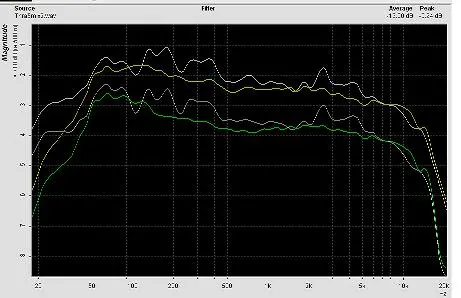

I tried to make visual where your problems are (darkeko) so I attached a file to this message (a freq line) white line is your file, not eqed, Green line is something I did 2 minutes ago. See the 2 peaks between 2000 and 5000? they are creating some sort of filtering problem, flange-like sound, find where it's from and kill it. The peaks between 100 and 500 don't do the flange sound, but make it unbalanced, bassy sound. (boosting the lows reduces the highs, as simple as that) find where it's from too.
killing the 2 high peaks kill the flange sound, killing the low peaks increases the high end
