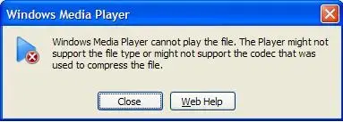

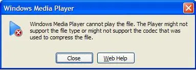

I can't open the file in WMP so I imagine others have the same problem.
