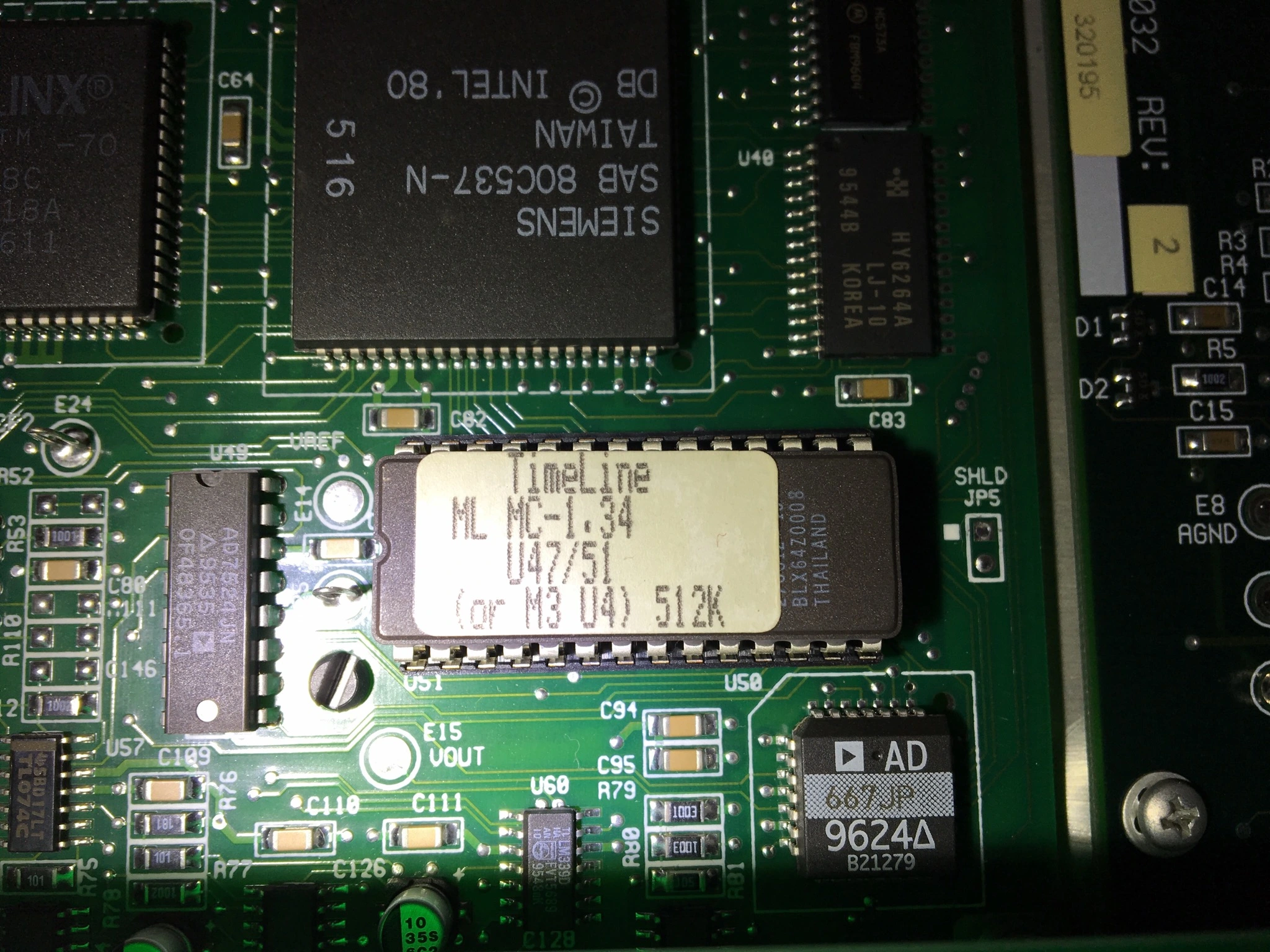

All of my transport control stuff is v1.34...U4, U47 and U51 on the main board are all v1.34:

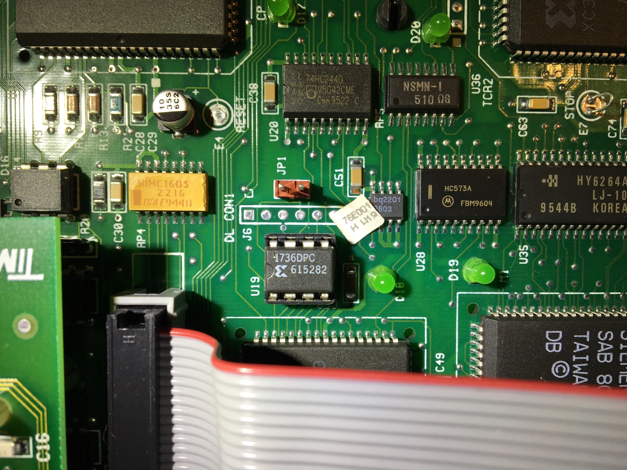

And [MENTION=198037]brainditch[/MENTION] I don’t know if this is useless information at this point but that DIP8 part U19 you were wondering about on the main board I *was* able to get the label off of that one...I don’t recognize the manufacturer logo on the chip...I’m sure one of you guys will know what it is, but it is marked “1736DPC” and “615282” under the label:
Another (maybe) point of interest, or maybe useless information, is a couple of interesting appearing socketed DIP16 parts at the backplane end of the main board, U58 and U59...I couldn’t see the top of the chips because of another PCB, but they are the same parts as U24 and U25 on the 3rd machine card which I was able to see easier. They are labeled “9606:” and “TLP627-4”. Here they are as found on the main board:

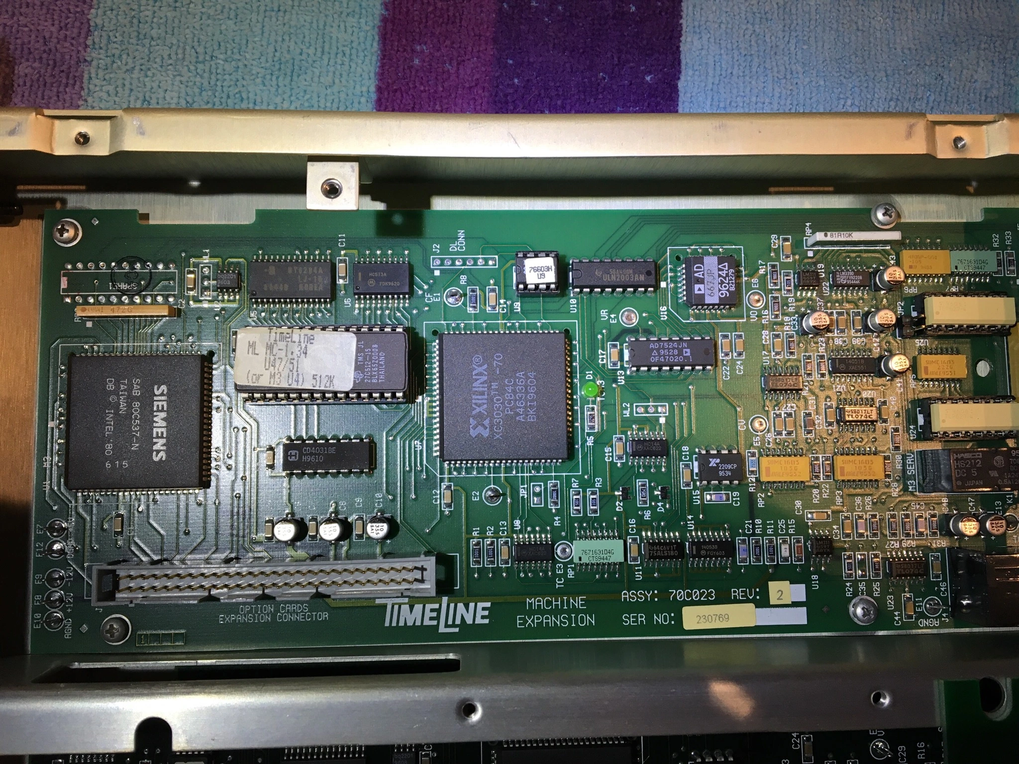

And here are the parts more clearly seen on the 3rd machine card:
Speaking of the 3rd machine card, the EPROM U4 and what I believe is the equivalent part to U19 on the main board, U9, look like the same parts as are found on the main board although U9 has a different number...I’m assuming this is a manufacture date/batch identifier, but it’s 615934 on the 3rd machine card as opposed to 615282 on the main board:
Here is the 3rd machine card in its entirety, officially named “Machine Expansion”:

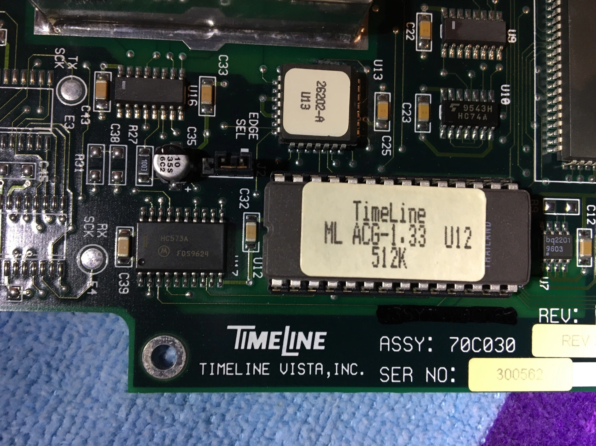

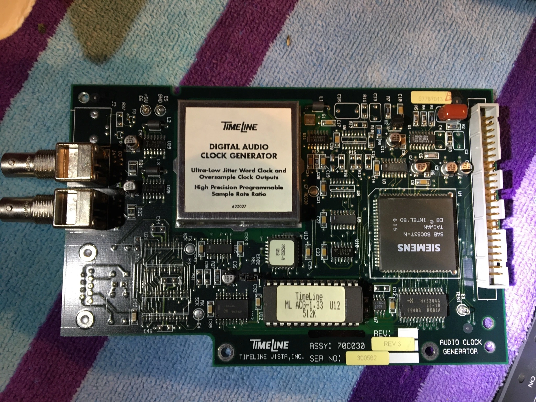

On to the Audio Clock Generator card...here it is in all its glory:
The EPROM U12 is ACG v1.33:

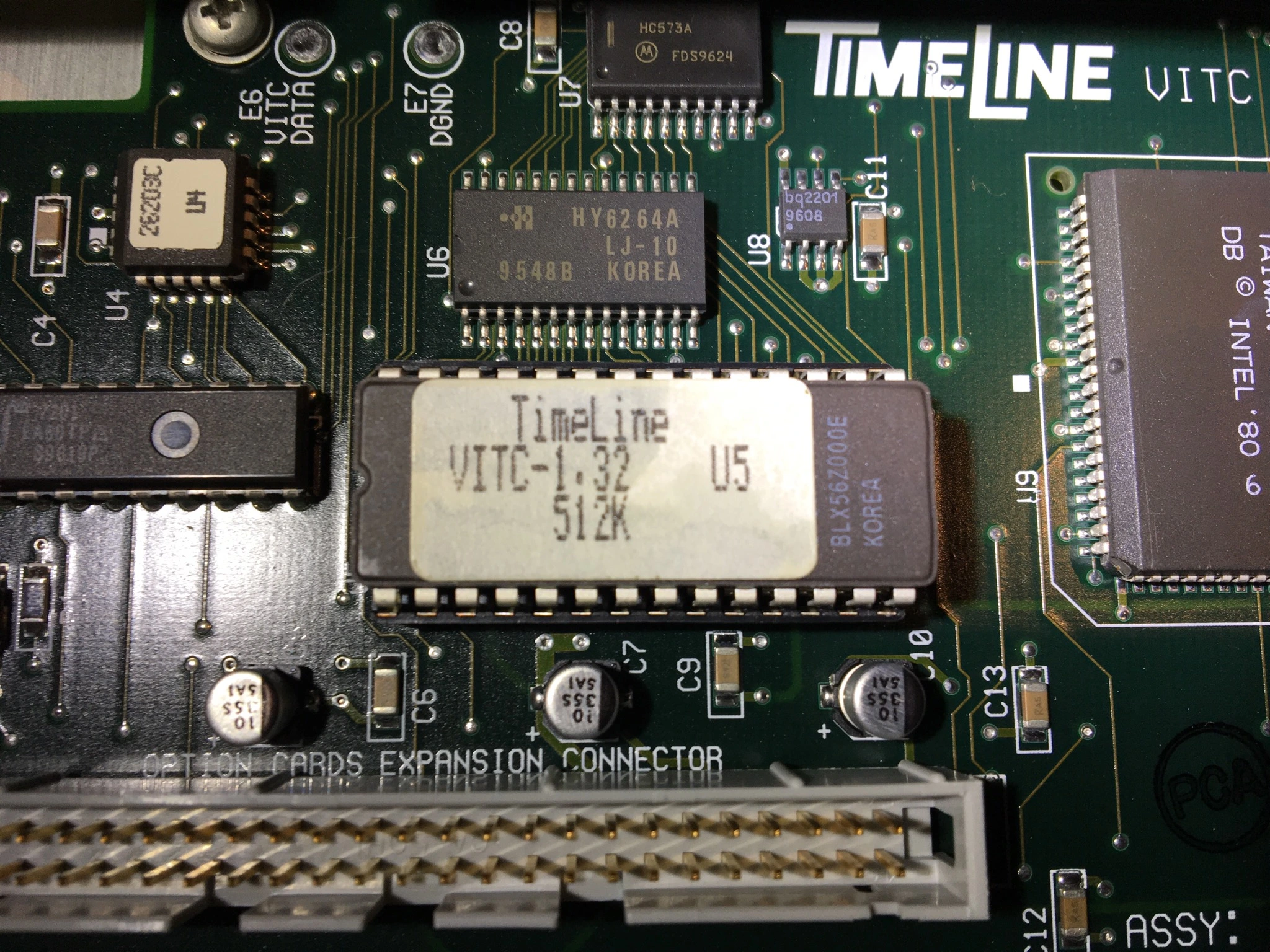

And lastly the VITC card:
It’s EPROM U5 is labeled VITC v1.32:
