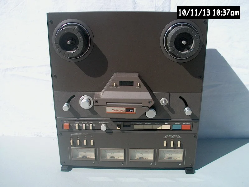

The last cal I did, Tascam 34, the manual said 3-4 overbias for 456 @ 250nWb/m, so I did 4db overbias on each channel. It just seemed easier and more accurate to shoot for 4 rather than 3.5. That's IIRC. I figured if the manual said 3-4db, anything in that range would be acceptable.
