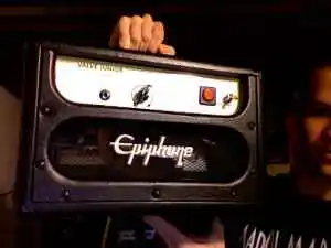

I did the "BitMo TRIO Mod Kit for Epiphone Valve Junior " found at www.thetubestore.com. I also put a standby switch in. The Trio mod does allow quite a range of sound shaping.
I bought the bitmo trio mod kit from the tube store also. I like it a whole lot.

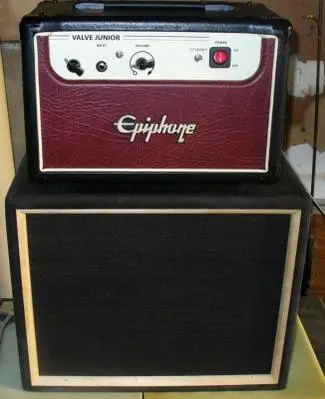

A little late to the party, but this one's mine, it's reversed in the case so you can see the innards from the front. Looks way cooler imo. The back is wide open, so I suppose it gets better ventilation too. It also has a standby switch, the JP1 mod, and a JJ 12at7 preamp tube in place of the stock 12ax7 for lower gain. It's my amp modding learning experience, I got it off CL for $50 so I'm not too worried about messing it up.
